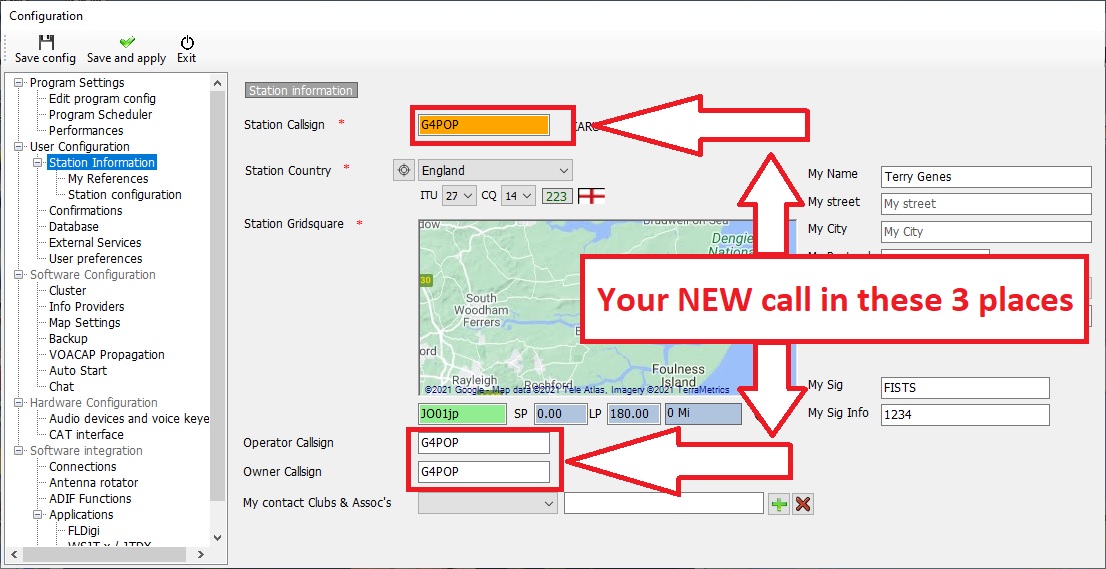

You should be using your new call sign as the station, user and owner call sign in the log4om config station info and also in the config confirmation section for are upload with the appropriate API key.

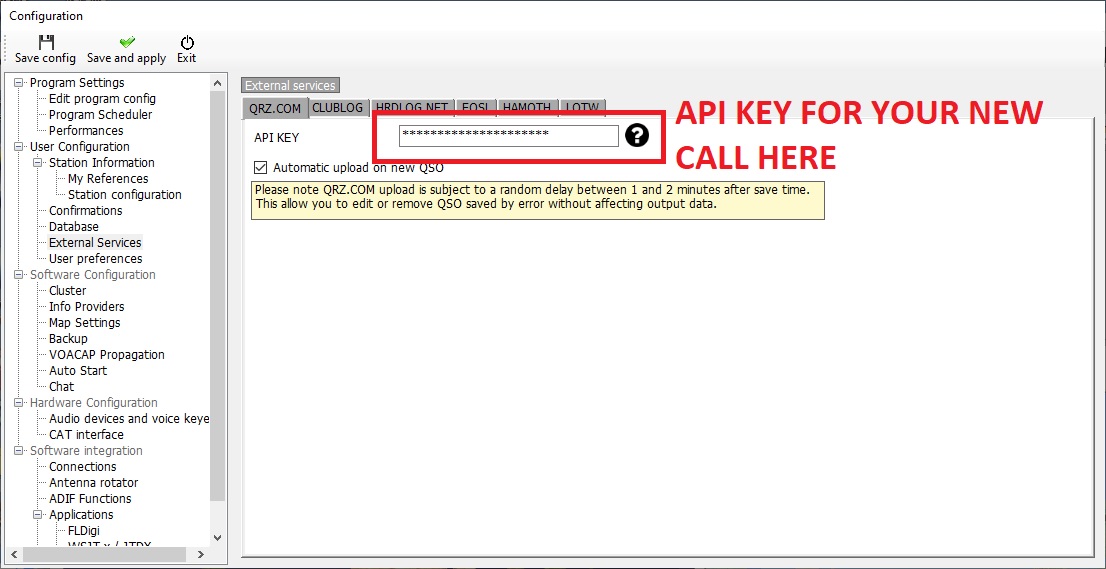

If you have set up as in the screen shots below then it should upload all QSO's in the Log4OM database that you logged using your new call to the QRZ logbook for that call.I have done all that you suggested and am not able to get the auto upload to work to the either of the qrz logbooks.

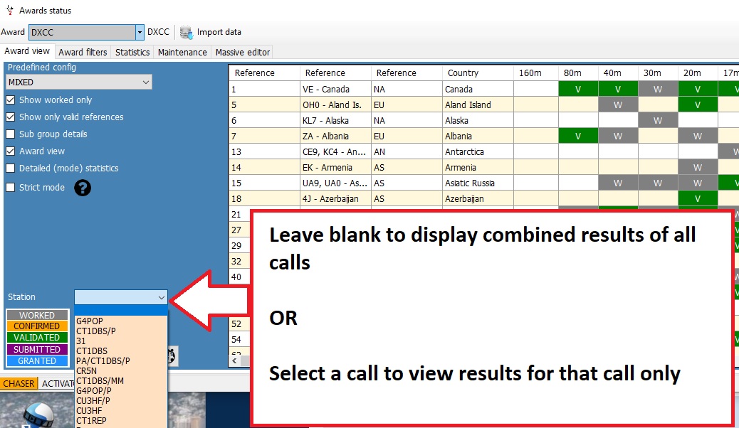

In log4OM you can view awards for both calls, your old call or your new call by selecting which you want to view
