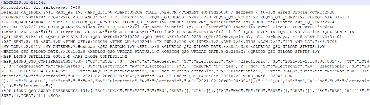

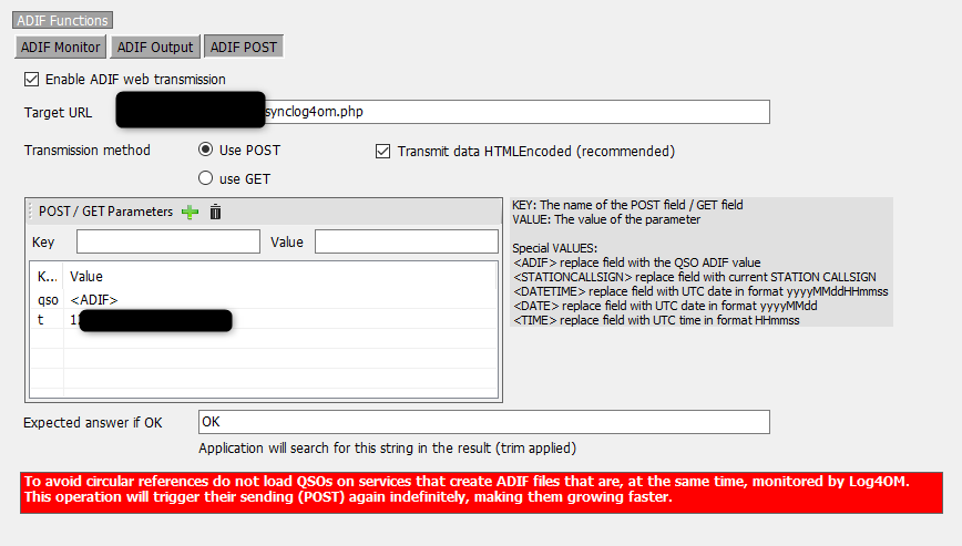

when using the export of a frame to a personal website
The received frame does not including the EOH tag which is the delimitation of the header of a file in ADIF format
For example :
It doesn't matter of course, I was able to continue my tests, but it would probably be wise to add it.
For information I managed to develop a file in PHP which allows me to recover this frame and to add this QSO in my personal database ...
