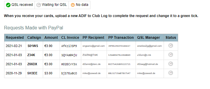

I upload my QSOs to Club Log. I also use the OQRS PayPal function to get some DXCCs.
After I receive a QSL card Clublog OQRS says "When you receive your cards, upload a new ADIF to Club Log to complete the request and change it to a green tick."

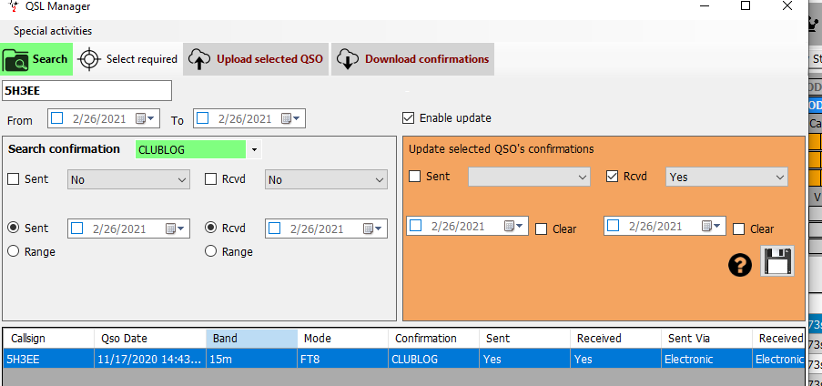

see attachment clublog1- that was what I had before clicking save on the disk except Received said no. After clicking save the No changed to Yes like you see in the attachment.
I then selected the QSO and clicked on "Upload selected QSO" and the upload to clublog showed the qso was accepted and I assumed updated at clublog.
Except clublog was NOT updated. If it was then call 5H3EE should have the green tick. See attachment clublog2.
Am I in the wrong place to do the confirmation update?

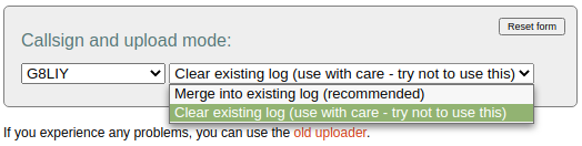

You can't "Update" existing records , but you can "Merge" New records
There is a "Merge" upload option on Clublog
73 Dave

Re: Send Confirmation to Clublog
Terry
Sorry to contradict yuu, but, YES, you can upload just one QSO, and have its status changed.
If it is already in the Clublog log, but is now changed as confirmed.
Check with a contact (or even country) that shows as W (worked). Change your log to confirmed and re-upload that QSO. Then the country will show as C (confirmed).
No need to re-upload all you log...
