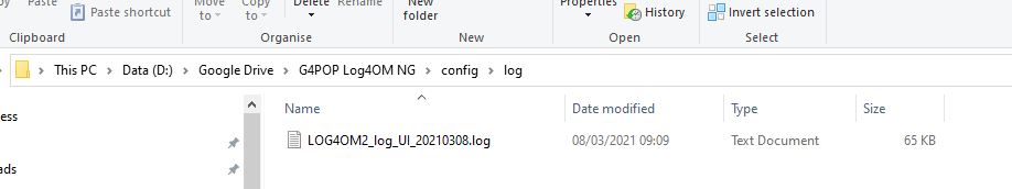

Please try to email me a log file before you restart log4om it will be in the portable folder containing these folders \config\log - below is the location and the file for my portable installation.
DO NOT POST THE FILE ON THE FORUM - Email it to me at g4pop (AT) arrl.net
