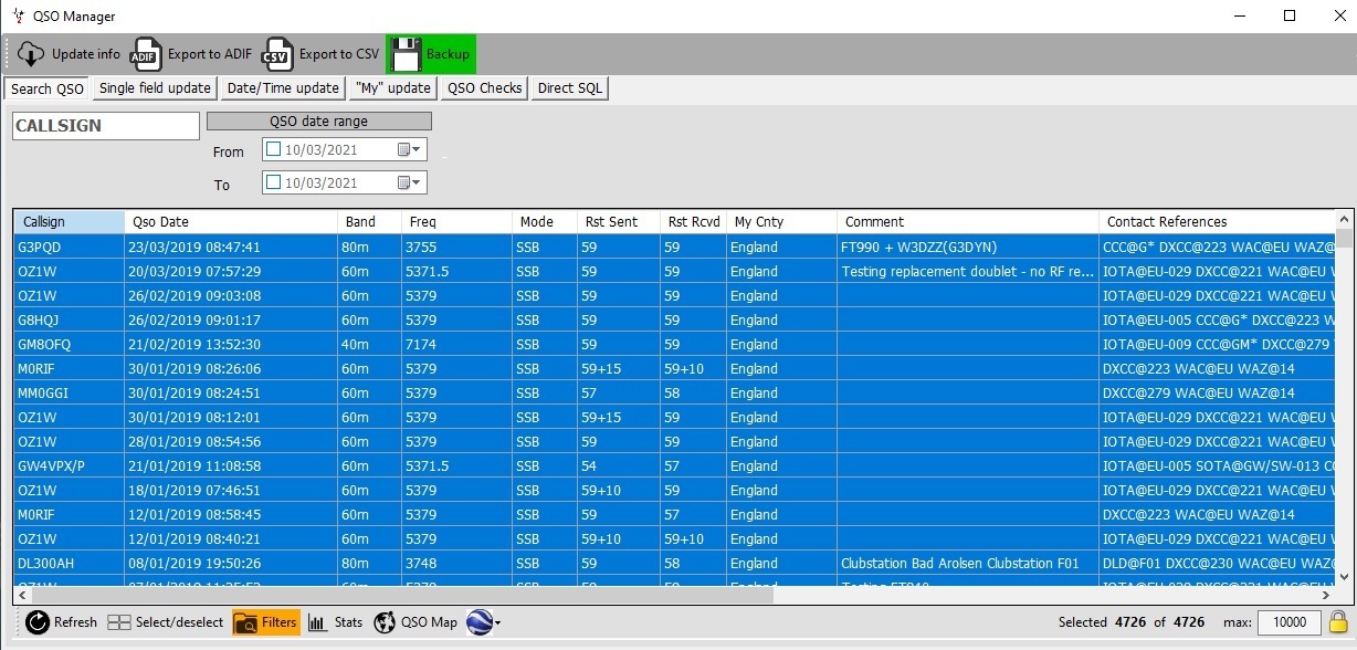

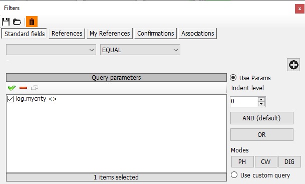

n4hcr wrote: 10 Mar 2021, 16:23 Hopefully there's a way to simply replace the value in the "My Cnty" column with Amherst.
QSO Manager set a filter (My CNTY - Not Equal to - Click plus sign)
Select/deselect button to select all

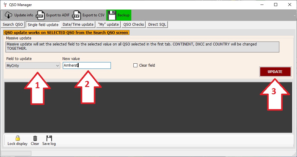

Single field edit - 1 Select the field, 2 enter your county, 3 click update
Finished - should take a couple of minutes
