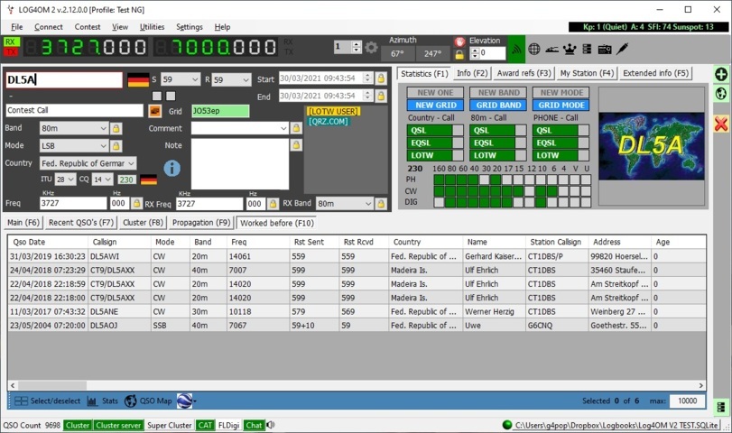

I'm a super-happy user of Log4OM for almost everything. Thanks for all the hard work that goes into this!
Am I missing, or are there any plans to do an N1MM style partial check? The Super Check files are open for folks to download/use ( http://www.supercheckpartial.com/ ) , so it'd just be implementation from what I understand. It'd be pretty useful even on the normal lookup screen, not just contesting mode.
Posts: 11591
Re: Partial lookup check?

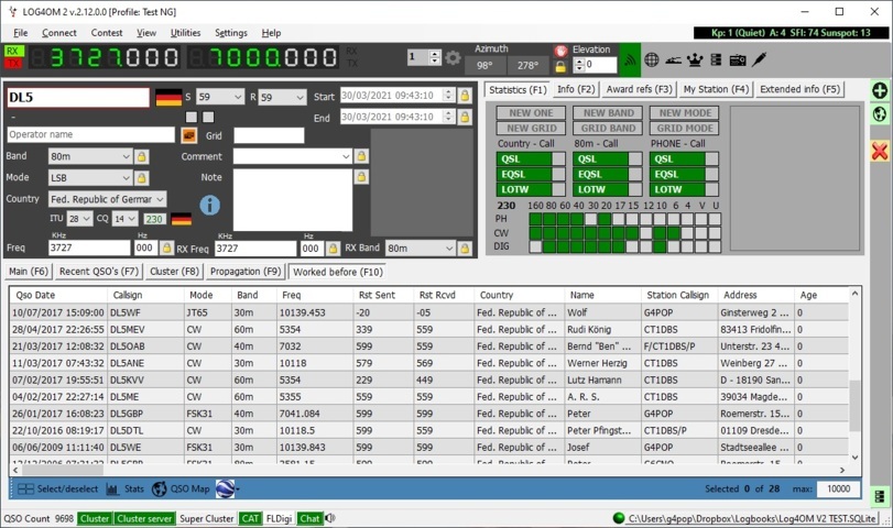

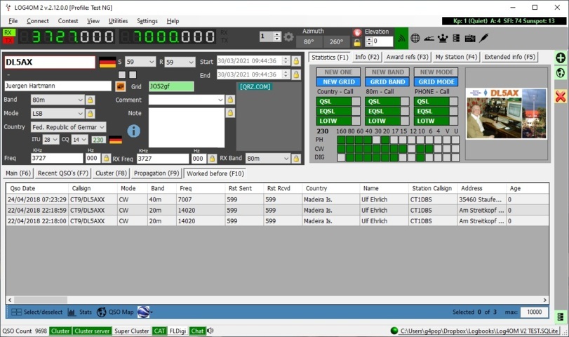

But you have that already in WB4, see below WB4 results as each successive letter is entered, except we display all of the QSO data not just the calls but you can select which fields are displayed
Untitled (FILEminimizer).jpg (144.79 KiB) Viewed 1535 times
Untitled2 (FILEminimizer).jpg (133.52 KiB) Viewed 1535 times
Untitled3 (FILEminimizer).jpg (116.37 KiB) Viewed 1535 times

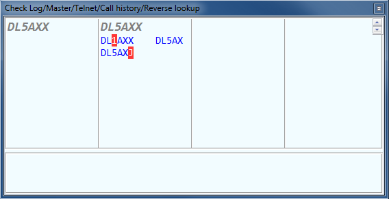

Post by KE0YBL »
Thanks Terry. Worked Before is helpful. However, the Super Check Partial tables are more around callsigns you've not already worked in the past. It's mostly based on contesting results, so not every ham in the planet, but it's helpful when trying to confirm a real light DXer's call. On occasion, I find myself firing up N1MM just to use that, and closing it again... which is silly. :)
