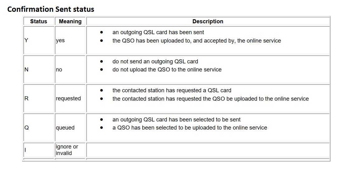

I watched the three Youtube Confirmation video's a couple of time trying to understand the different QSL Sent
and Receive settings, like No, Yes, Requested, Queued and how this works out in practice to the External Services.
I have enabled automatic upload to eQSL and HRDLOG.
When setting eQSL Sent to Yes, the QSO is registered in my Outbox at eQSL.
Setting HRDLOG Sent to Yes, nothing is registered in HRDLOG. Changing Sent to Requested, my QSO is registered at HRDLOG.
In what situations is Yes, No, Requested or Queued used? Totally unclear to me.
Wish there is a table where the External Services are horizontally lined and the confirmation settings vertically showing
the practical result for each External Service.
I have enabled automatic upload to LOTW at program closure, but nothing is registered in LOTW.
Now using the QSL Manager option Select required"" followed by the Upload requested QSO"", this works fine.
Using the QSL Manager"Select reuired" for eQSL and HRDLOG, shows all my QSO's made so far although they are already uploaded automatically.
As you may understand, the Confirmation process is not clear to me.
Any help is highly appreciated.
73, Fred

I am not sure how we can help you having detailed this extensively in the user guide and having provided three instructional videos?
I think you probably need to re-think the confirmation 'Sent Status' and watch the early part of the video where I explain why there is No and also requested.
Page 98 of the user guide explains in detail
Extract
Setting the sent status of any QSO yo Yes will stop it being uploaded because Yes indicates its already been uploaded

Not sure I understand the difference between queued and requested.
Does that mean you first can change "no" to "queued", and then from "queued" to requested" while there is no other operation involved ??
Why not go direct from "no" to "requested" ?
Thanks + 73
Paul F6EXV
Re: QSL Confirmation struggle
F6EXV wrote: 08 Apr 2021, 07:55 Hiall
I don't use queued or requested, to me the confirmation is either sent (Y) or not sent (n) or I might mark a qso as Ignore(I) where it's a friend that I work every day.
Queued and requests were landed on us by ADIF but if you watch my video I explain that us old codgers never had those states when logging using paper so I don't change now
I use "Requested" for QSL´s which i have ordered via OQRS like ClubLog or other OQRS services.
All my QSL send statuses are at "No" but if i received a card i set to send = "Quequed". With this
option i search the Log for the label print. So i send only cards if i receive qsl before. After
print the send status will be set to "Yes" from the label print facility in Log4OM.
My way to play with it .... ;) ;)

The oddity for me is that in several examples here and on Youtube LotW asking in Log4OM is set to "NO" but in Terry's chart the description, to me, implies your DON't want to send a QSL via LoTW ?
Andy K3UK
k3uk wrote: 30 Jul 2022, 04:51 The oddity for me is that in several examples here and on Youtube LotW asking in Log4OM is set to "NO" but in Terry's chart the description, to me, implies your DON't want to send a QSL via LoTW ?
Andy K3UK
Andy,
Confusion/understanding is underfoot here.
As Terry suggested on your other thread's comments I've sent you an e-mail seeking a time where I can call you and go over the confirmations situation to try and help smooth out the speedbumps.
Check your e-mail.
