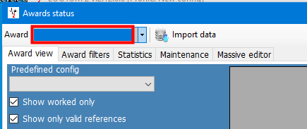

Hi all,
Don't know when it happened. Been using the portable version since a long time, copying new versions over previous ones (but only those files which had a more recent date). Running 2.12.0.0 now.
Wanted to check my award status, but the award list is empty! Went into Settings > Update resources > Log4OM awards, which resulted in a total of 61 award_....xml files being downloaded to the config\temp folder, but the award list is still empty. Do I have to run "Rescan Award References" over my15k+ QSOs?
Thanks for any hint.
73, Markus HB9BRJ
Re: View > Award status: Award list empty
Which award list Markus?
Post by HB9BRJ »
This one Terry:
In the database, the award references are still there in the "contactreferences" column.
73, Markus HB9BRJ

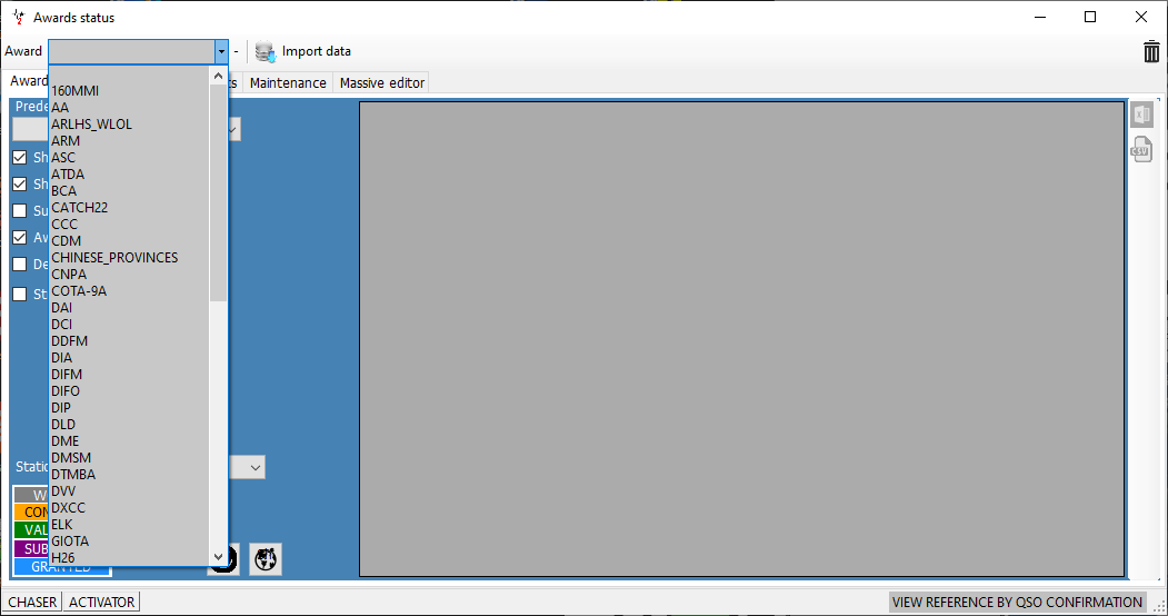

Hi Markus,
i have updated my portable version (use it for the Clubcall) updated as you did and all awards are there.
Only thing i did, i have replaced all the files with these from v2.12. My german windows shows "Alle
Dateien im Ziel ersetzen" and i hit it. All is fine in the new version here.
Maybe you try to copy the Portable directory again and overwrite all files as i did. ;) ;)
Post by HB9BRJ »
Thank you Terry and Juergen!
Since my database is stored elsewhere, replacing all Log4OM files when updating my portable installation makes sense. This solved my problem.
Only reason for not overwriting newer files in the past was fear that some of my customizations such as mode/band lists might be lost. Apparently this is not the case 8-)
73, Markus HB9BRJ
Hello Markus,
nothing will be lost so the database is userdefined and also the setup. So the json file for your
own config won´t be overwritten nor the sqlite file of your own setup. It´s the same as with the
"installed" Version. You can install over the old installation but the files for your setup and your
database wouldn´t be overwritten. If you restart after an update all should be safe.
By the way, don´t forget to setting up a backup ... ;) ;)
