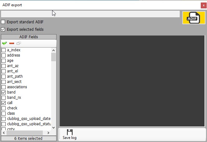

if I run an adif export via the File / Export ADIF menu, Log4OM shows me a window with different choices :
I can export only standard ADIF fields (Standard ADIF export)
OR
export différent fields that I select (Export selected fields) (and thank you for having sorted the names of these fields in alphabetical order as I had had the opportunity to ask)
OR
if no box is checked, Log4OM exports all the fields used :
in fact Log4OM does not export the Reference 1 or 2 fields nor the Association 1 or 2 fields
1) ==> my first suggestion is therefore to be able to export these fields
II) now I want to export a certain number of QSOs in ADIF, I go through the menu "Utilities / QSO Manager", then I select the QSOs that I want to export in ADIF format by a right click in the window, after having selected my QSOs at export
I select "Export selected to ADIF"
Well in this case I don't have the window of choice as before, Log4OM directly exports all the fields
2) ==> my second suggestion is that in this case we can also have the choice to export what we want as in case 1, and that would be more consistent, there is no reason that it should be different

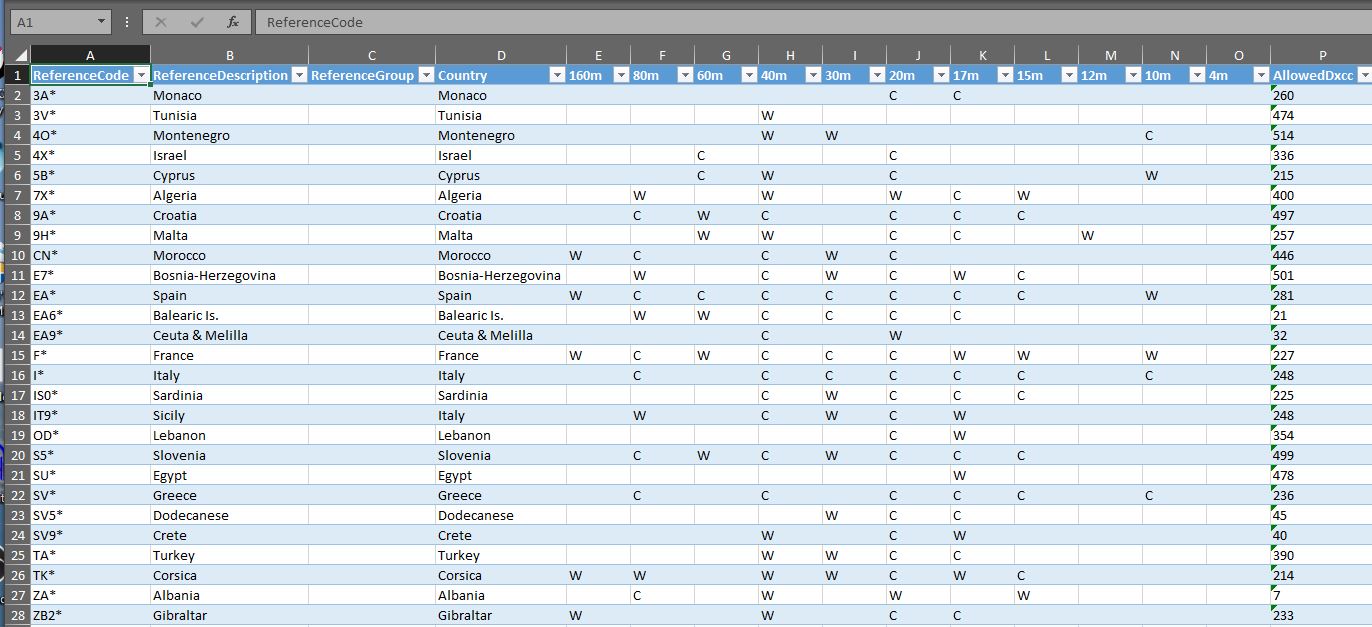

Well it would help a lot if you tell me exactly what you are trying to achieve and why you have the need to export a specific reference field, then just possibly I might be able to offer you some helpfull advice.
You could of course export from the awards statistics if you just want a list of specific award results?
Example of an Excel export of Certificato del Mediterraneo award results from our Award statistics
Within Log4OM we filter those references as we need to apply them, we only export them to adif as a support for Log4OM users that might have to do a backup and want to re-establish those references during a restore.
We are forced to do it this way due to the inadequacies of the ADIF specification because it does not properly support award references apart from DXCC, IOTA, SOTA etc.
To export fields for each award reference would require hundreds of extra fields in the adif export!
