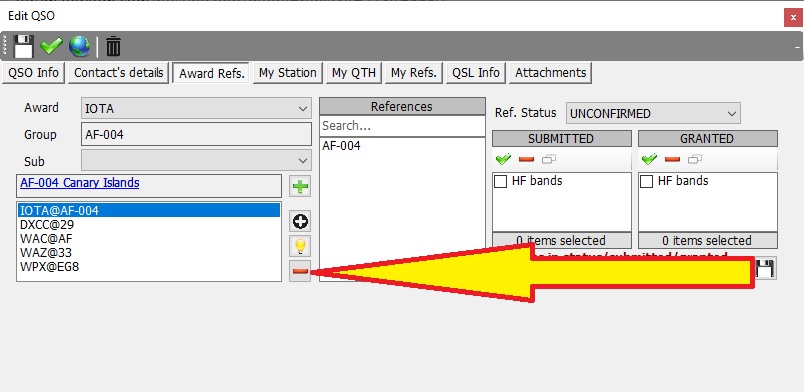

Your description is difficult for me to understand but if you need to remove an IOTA ref from a QSO then do it in the QSO edit/award refs tab by selecting the ref and clicking the minus sign indicated followed by save and apply
Then rescan the references
NOTE_ Make sure the references is not also in the comments field of the QSO or the rescan will find it and replace the award reference

Your final comment in red was the answer. My own fault since transferring contacts and updating using
the adif export from an much older logging program. I had placed a note in the comments on my other
old program about VO2AAA and only july 2005 contacts were at NA-044 thus it was picked up from my
own comments. Couldn't understand when deleting it came back again using update. ALL EXCELLENT NOW.
Very many thanks for help and now everything appears correct for claiming awards. Regards, Keith
