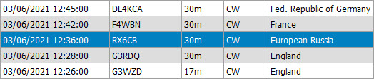

Entering all data from SOTA, all looked good. Until I noticed that the QSO's had been uploaded as 30M, even if my log say 17M.
My log:

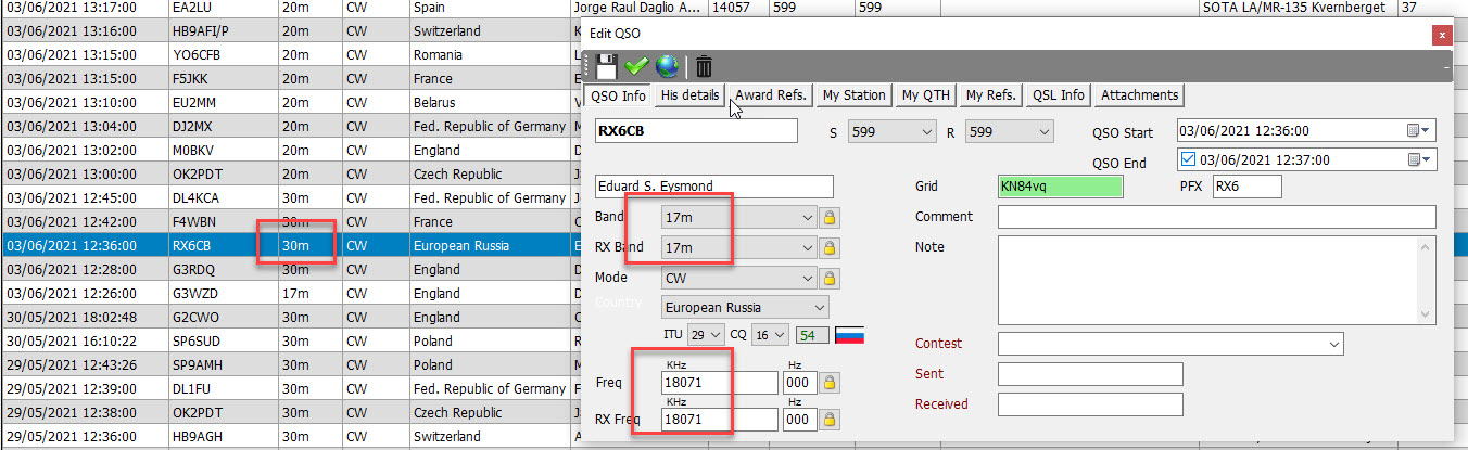

Editing one of the QSO's:

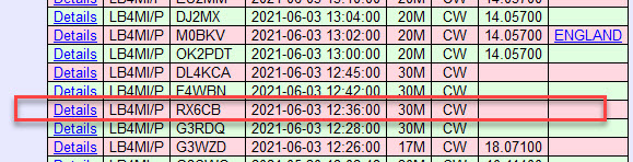

Showing the "result" in LOTW:
Any ideas?
UPDATE: If I click "Refresh data" in the "Edit QSO", it changes to correct band... So perhaps a bug I provoked here...

yes, when I enter my portable QSO's into Log4OM, I set my radio to the frequency and mode that I used portable. Then I only change the time/date to the QSO time.
Then I don't have to enter frequency/mode for each QSO.
Is this part of issue, perhaps?
Posts: 11593
Re: Logged as 17M, showing as 30M, LOTW as 30M
Probably had a 30m frequency in the field when you were logging and on save it derived the band from the frequency.
Best to stop CAT from the connect menu and then having set the freq and mode lock both
