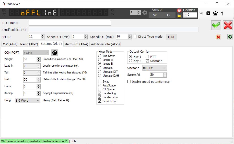

I've attached the Log4OM V2 WK Settings that I am using and are working for me. Have you tested your macro's in the Log4OM V2 WK Macro Tab? I can hear a tone output on my WK-USB if something is cut off during that test.

- ki5io-WK_USB.JPG (84.72 KiB) Viewed 8250 times

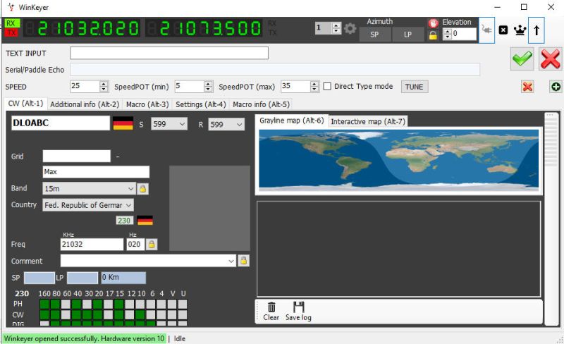

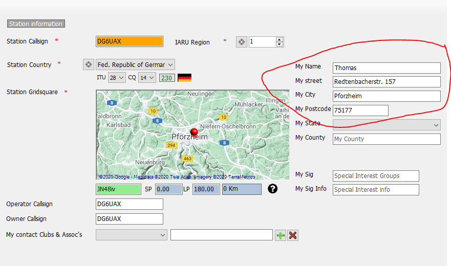

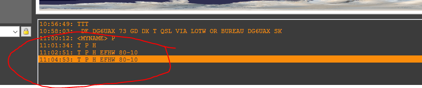

I use the Winkeyer in other apps without problems. Log4OM also uses some parameters like <MY_ANTENNA> correct, but for NAME, QTH HIS_NAME I only get the first letter.
I have the same setup as yours. Have a look at my screenshots, there you can see the output with the single letter and my personal settings.
vy 73 Thomas DG6UAX

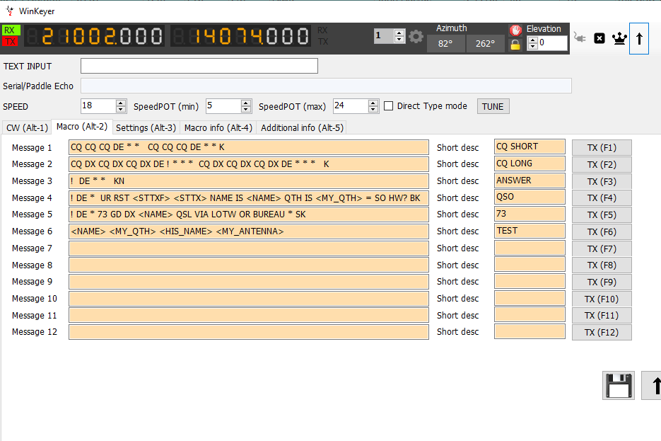

Ich kann da leider wenig zu beitragen. Ich habe zwar auch ein Modem mit integriertem Winkeyer
aber leider nicht dieses. Meiner Ansicht nach sehen die Befehle in den Macros o.k. aus was mich
nur wundert wo im oberen Screenshot das <MYNAME> herkommt denn das ist ja nicht korrekt. Aber
wie gesagt, in den Macros sieht das für mich ok aus.

Re: Winkeyer Macro Problem
Thomas,
I'm able to replicate your issue and have added it to our "fix" list.
Thomas,DG6UAX wrote: 15 Nov 2020, 17:12 Nolan,
that´s perfect - tnx for your support and your great software
73 Thomas
At long last ... Lele was able to carve out some time and got a fix for this WK Macro issue. I've been testing all day and it has been working FB.
It will be in the next maintenance release. We're working on a number of items and the wait should not be too long.

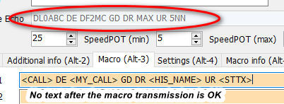

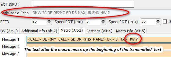

Sorry to say,
in my case Iam using a microham KEYER II, CW-Winkeyer in V2 2.13 still not working.
When I use macros e.g. <STTX> and additional text the transmitted text gets messed up.
I have bin playing around a lot, but no chance to fix it.
Please see the attached picture.
Any ideas, is it the behavior of the microham KEYER II ??

Best 73 Hans, DF2MC
QSO-Data
Messed up Text
no Text -HW?- after the macro <STTX> transmission is OK
