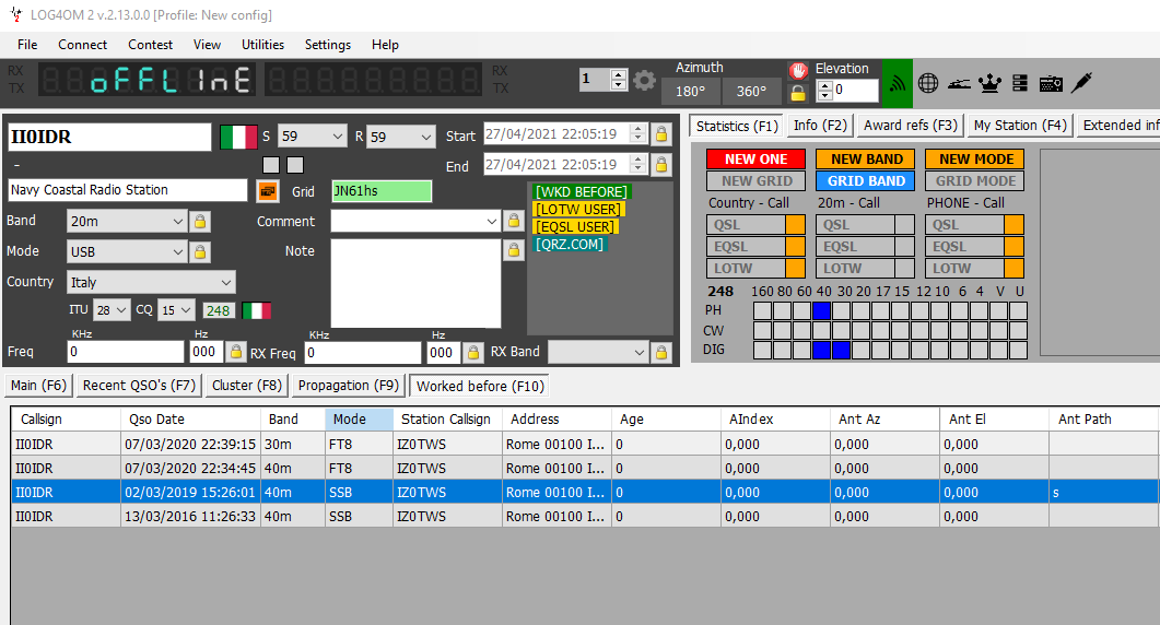

iz0tws
Posts: 13
Joined: 03 Apr 2016, 11:23
Re: Worked before function always empty
Post by iz0tws »
As you can see there is some issue here.
No new Band, No New One, No New Mode
The only difference is that I'm using a Mysql database for storing data, but I do not know if this worked flag are stored there or calculated in a realtime fashion.
