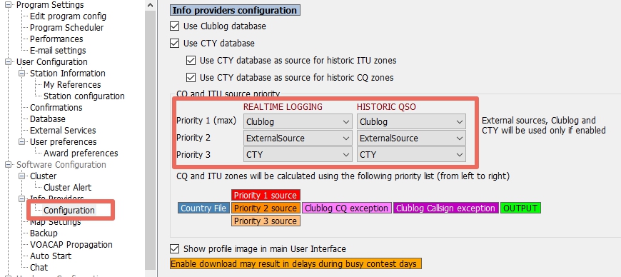

Re: ZONES 18, 19, 3, 4 INSERTION ON LOG
Hi Daniel,
Bad news:
For many calls it's not possible to determine the correct CQZ and/or ITUZ. Either a callsign block (e.g. K0) is in more than one zone, or the owner moved, etc. This is the case for most of the US and UA callsigns.
Good news:
You easily can fix this in Log4OM if you're using e.g. QRZ.com (but not all zones are correct there as well).
Go to Configuration -> Info providers -> Configuration and change the sequence under "REALTIME LOGGING". Most probably in your configuration you will have CTY set as priority 1.
In my configuration, I put Clublog on top, followed by ExternalSource (which is QRZ.com in my case) and last is CTY. Don't forget to save and apply any changes. If you check again with K0PT, you will see now CQZ 5 and ITUZ 8.
Claus
Bad news:
Good news:
Claus
Claus, OE6CLD/DJ0DX/EI7JZ
Hello Claus
Thank you very much , indeed by adjusting as you show there is no more error ...
Thank you so much
Thank you so much
Dan - F6FLU
https://F6FLU.org
https://F6FLU.org

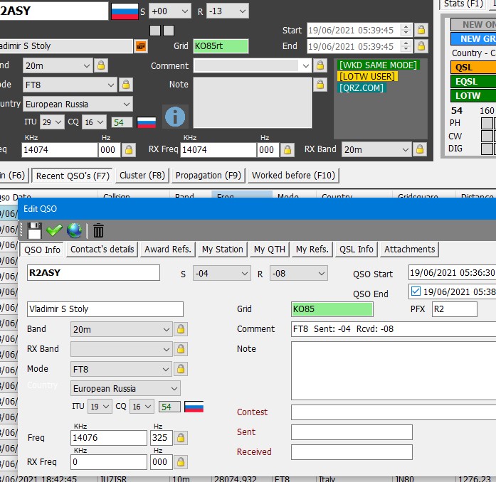

bonjour a tous
je viens de mettre la meme configuration, mais cela ne fonctionne toujours pas chez moi
- Capture d’écran 2021-06-19 073957.jpg (133.49 KiB) Viewed 5734 times
Laurent,
Your recent post reflects your QSO input from an FTxx APP and you noted above that you have observed this since V 2.9.0.0 ...
I have observed and experience the same thing with some anomaly with the data input from an FTxx APP to Log4OM V2.
ITU and CQ zones appear FB in Main UI, but once the QSO is 'saved' the resulting ITU & CQ zone gets changed.
What Dan and Claus seemed to be addressing were manually input callsigns or callsigns input from a cluster or band-map click.
Data coming from the FTxx APPs is somehow or another doing something different.
Yes Nolan
I confirm that the tests carried out here were done by manually typing the call, I did not test by validating this same callsign from an FTxx digital mode interface, but if necessary I can give it a try…
Yes Nolan
