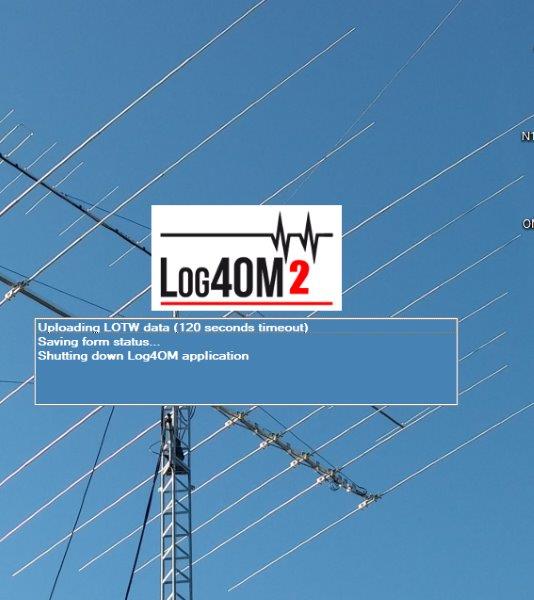

Je n'ai rien changer dans ma configuration mais depuis plusieurs jours LOG4OM ne se ferme plus lorsque je fais "exit" dans l'application.
Je reste avec la fenêtre de la pièce jointe.
je suis obligé d'allé dans le gestionnaire de tache pour arrêter l'application.

What Log4om release number?

Hello Terry !
My version is V2.14.1.0

Turn off AUTO LOTW uploads if your using that and see if that helps

Danielle, Terry and team.
I too have this issue after upgrading to 2.14.1.0.
By turning off auto LOTW upload, the problem disappears.
Hope to read of a solution in the future.

Kev,
Not everyone is experiencing the same, but Lele is working on a solid/stable repair.
In the meantime ... you can still upload your LOTW QSOs via the manual routine in QSL Manager.
I tend to use the manual routines all the time for my station. Just a personal preference.
