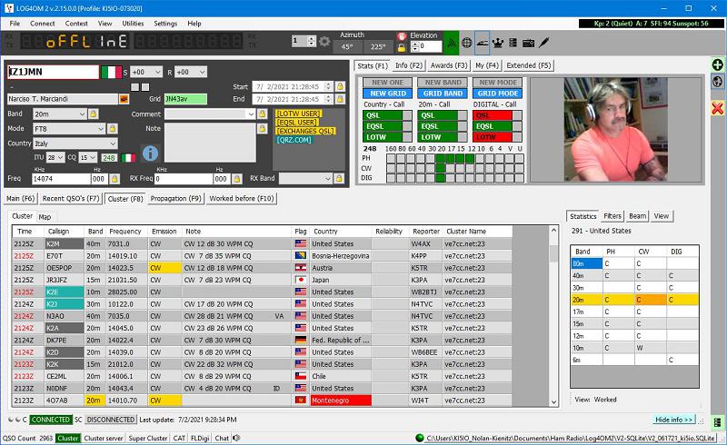

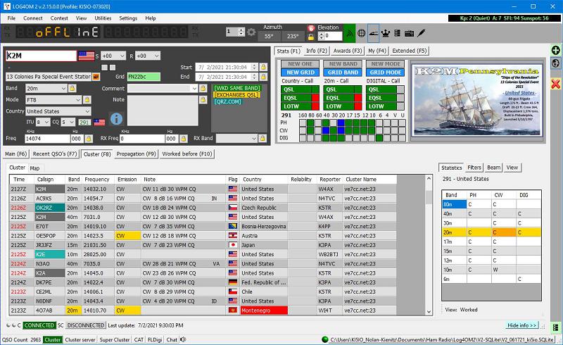

Just did some testing ... as best I could from your initial post.
I followed the settings in our User Guide for using JTAlert. They start on Page 205 of the "current" User Guide.
I used WSJTx (current Beta release) and current JTAlert. JTAlert is feeding the data from WSJTx through JTAlert and then into Log4OM V2.
I double-clicked on a call in the JTAlert callsign/window panel and that data immediately populated the Log4OM V2 Main UI. I tried several different calls and captured images of two of them and have attached them below.
Seems to me that statistics did appear. Could you provide similar screen clips of what your installation looks like without statistics?
- FTxx_statistics_MainUI-2.JPG (111 KiB) Viewed 2977 times
- FTxx_statistics_MainUI.JPG (107.91 KiB) Viewed 2977 times
