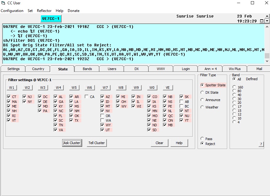

Hi Nolan,
I tried something a little different. This may make it clearer, or probably more confusing. In CC User I changed the server setting to reject all states expect the ones I want (previously I had set it to accept only the ones I want).
CC User settings:

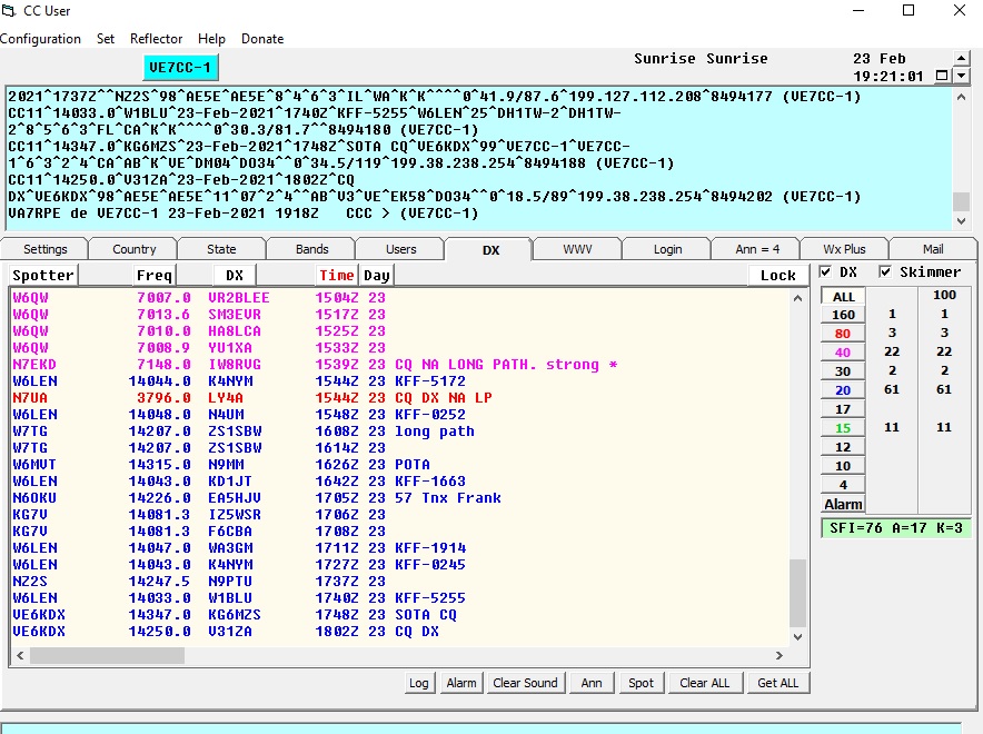

Here are the spot results inside CC User:
VE7CC Cluster report.jpg (238.12 KiB) Viewed 1233 times

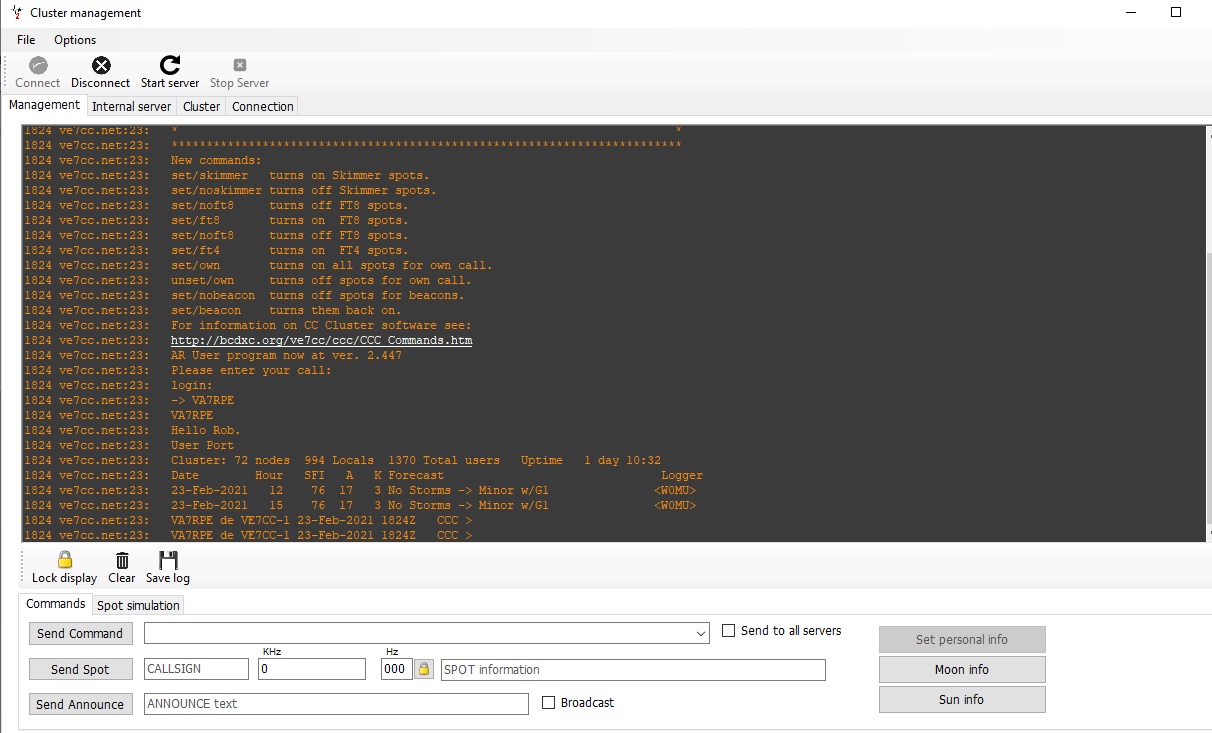

Log4OM reports no spots. Here is the Management Tab of the cluster:
Log4OM Cluster report.jpg (193.89 KiB) Viewed 1233 times
