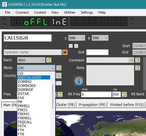

Log4OM2 v2.16.0.0 There is no Digital Voice in the mode dropdown in the main QSO entry screen. If i open a QSO for Editing by double clicking on the QSO on the main screen, in the edit QSO in the mode drop down I see Digital Voice and other. How does one get Digital Voice to show up in the main entry screen mode drop down.

Well it works fine for me when I tested just now

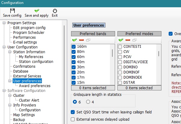

Are you sure that you did not turn it off in the program config?

Thank You Terry,
Appreciate your prompt reply, it was the User preferences where it was not set.
