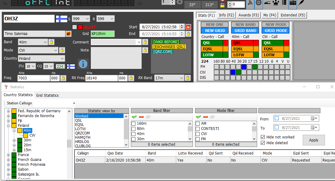

I don't understand the coloring I'm seeing in both the Country Statisitc dialog and on the Stats (F1) display.
I have OH3Z LoTW confirmed on 40m CW yet in both places LoTW is displayed in Yellow as Unconfirmed. See attached. (yet stranglely, for 40m - Call, I've got a green box?)
Mike
Log4Om v 2.16.0.0
U.G: 06.08.2021
Country Statistics coloring
- Screenshot 2021-08-27 110235.png (77.91 KiB) Viewed 1522 times

Re: Country Statistics coloring
In the input pane shown at top of your screengrab
Top section refers to grids
Indicates worked by bands and modes
Middle section refers to the confirmation status for:
Column 1 = The country
Column 2 - The CURRENT band
Column 3 - The CURRENT mode
Small squares next to each rectangle refers to the ACTUAL call sign - Blue if worked on the band/mode
No colour = Not worked
Orange = Worked and confirmation received but not validated
Green = Worked and validated
Bottom section
This refers specifically to the Country (DXCC entity) and shows the bands/modes the COUNTRY had been worked on.
In bottom part of your screengrab
The statistics window and awards statistics use the same colours but the result depends on the 'Statistics view by' selection
Full details are in the user guide
I understand all that but my question is; why is in the middle section, 40m (rectangle but not Call/square) and on the Statistics tree (Finland->40m->CW square) are not showing LOTW confirmed (green) when that call (OH3Z) is indeed confirmed (see the Statistic view I included)? In the Statistics view it seems view by of Worked is colored if a station is confirmed by any method. (I do not see view by Worked explained in the manual). So, OH3Z is confirmed so why is it not green with view by set to Worked?

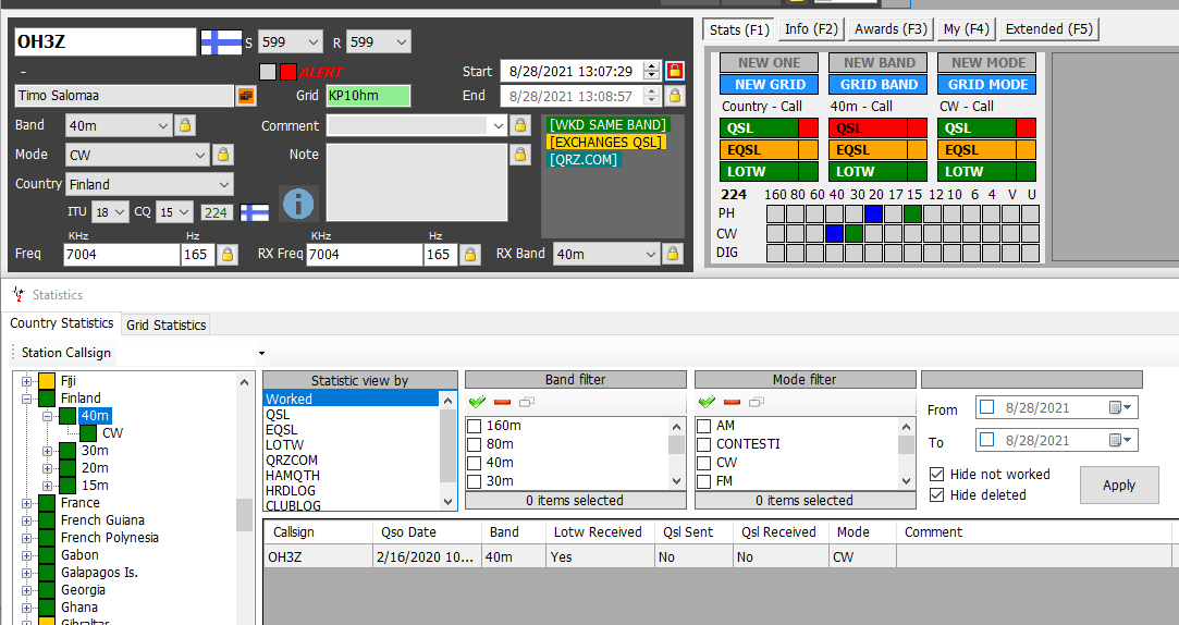

WHAT!!! - just went to re-create the colors (and play w/ view by) and now, it is correct!? (attached). I think there bugs. I do not feel I had an operator error in my original post. Very frustrating!!
Mike / KA4CDN

- Screenshot 2021-08-28 090936.png (68.8 KiB) Viewed 1501 times
