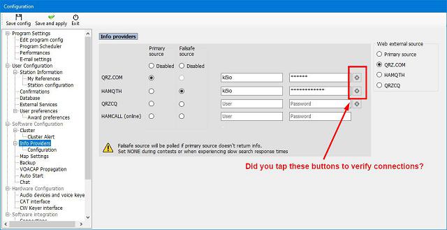

Re: Label Print No Lookup
k9bm wrote: 01 Oct 2021, 23:26 Hmmm, actually no, it doesn't. So far I've only used Log4OM with WSJT-Z so I haven't entered any manual contacts. But I tested it and it only gives me the country or, if a US callsign, the state. So I guess that's where I need to start troubleshooting. I can't imagine what I have configured wrong, again I have every tab populated with a user account and password under external services in the configuration screen....
Brad,
Check your connections to QRZ or HamQTH on the Info Providers tab in the Configuration. You need to tap the little buttons on the right side to "test & verify" your connections. If you get those working you will then starting seeing data in many places in Log4OM-2

Sigh. I missed that section entirely, I only configured the External Services section. Needless to say, when I entered the (same) info in Info Providers, it magically started to work. Mea culpa, I thought I had RTFM but obviously I read too fast. I'm grateful for the hand holding!
