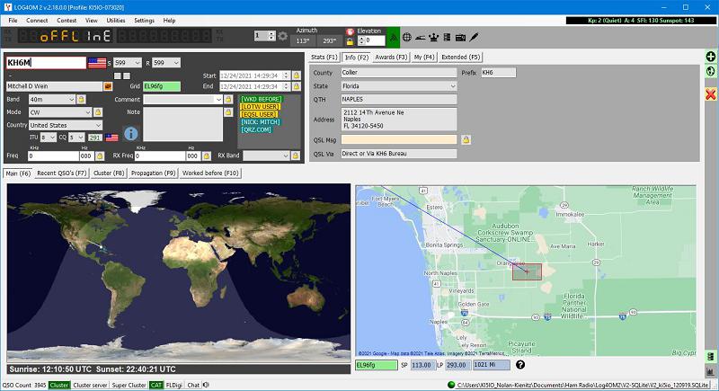

KH6M resolves properly in my installation. Are you using the most current version of Log4OM V2? You didn't indicate that in your message. The version ID is located in top left of the Main UI Title Bar. I am using V 2.18.0.0

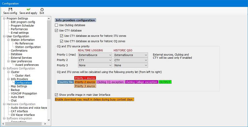

Your resolutions of callsigns can/will be affected by the settings you have chosen in the Information Providers in Configuration. I've included a screen clip of my current settings for those and I do change them from time to time.
The current programming is working ... it is how you have things configured in your installation.
- Zone-check-kh6m-medium.JPG (54.91 KiB) Viewed 3382 times
- Main-UI-Zone-check-kh6m-medium.JPG (72.63 KiB) Viewed 3382 times
- InfoProviders-medium.JPG (55.94 KiB) Viewed 3382 times

I use the same version of the Log4OM (2.18.0.0 - always I use the latest update) and the settings page, in Configurations, looks exactly like yours.
