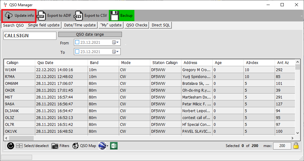

Re: Bulk edit and external lookups
Hello Tony,
we´re in the christmas time and some guys like to do other things than reading in the forums
and answering questions. By the way, 76 readers don´t mean that those are 76 different
persons. Each time if a visitor is reading a post it´s count as one more. So it´s possible that
there was only a handfull of operators that have visitied your thread.
By the way, open the QSO Manager, search for the contacts you like to update, select them
all and hit "Update Info" at the upper left. Could be need a while if you select a bunch of
contacts. That´s the way for a multiple lookup.
Merry christmas and a happy new year ....

DF5WW wrote: 23 Dec 2021, 08:07 Hello Tony,
Merry christmas and a happy new year ....![]()

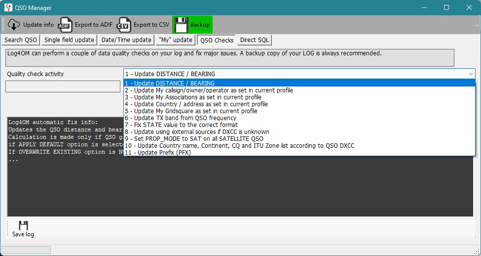

Please Please, user guide Page 94VK2MET wrote: 27 Dec 2021, 09:01 Hi,
The Update Info works well for general lookup info. Is there a similar bulk operation for updating the Distance field? To avoid having to open and update each QSO manually which does update the Distance.
Alan
Yes - Terry. I have that. but I notice that after the update info executes, the Recent QSO listing reflects all the updated information but the Distances ARE STILL 0.
BUT, After you save a QSO with a single edit, the Recent QSOs list is all refreshed WITH the distances.
It would seem that Update Info does work to update distances but this calc must execute AFTER the initial info update requests a page refresh and so the distances DO NOT show immediately - thus my misunderstanding.
Alan
