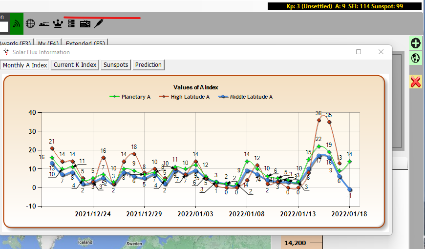

Working here, what Log4OM version are you using - Help/About
Screenshot 2022-01-18 084555.png (117.73 KiB) Viewed 2064 times
