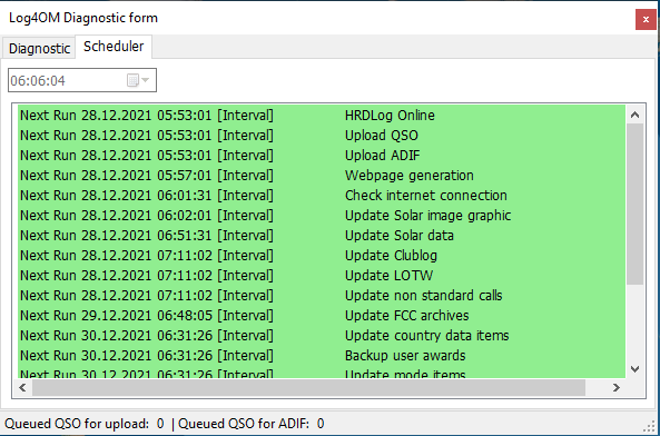

Just installed 2.18.0 version to check if anything has changed... Nope, the last working version for me is 2.14.1 and I just noticed a strange thing... The scheduler looks like not working, take a look on a screenshot - I started the logger about 5:52, it's 6:06 and you can see the jobs which should have been processed over 10 minutes ago - correct me if I'm wrong.
There was one job (webpage creation) scheduled to year 1900 before the image was taken. I thought it might hold the queue and configured this in settings, but as you can see - nothing really happened.
Is there any scheduler log? I turned on realtime log viewer with trace level but there's nothing about sched jobs.
Operating system is Windows10 64bit and belive me - reinstalling to 2.14.1 makes all working again. :?

Thread update...
It seems LOG4OM2 (2.18.0) is working as expected again. I just deinstalled the old version, removed all the user files (sqlite database, Log4OM2 folder located in AppData\Roaming). Of course - I did backup it before, exported all QSO to adif, then installed new version, restored config, recreated database and finally imported all QSO from previously made backup.
I really have no idea what was wrong but I hope it's solution for people having similar problems.
