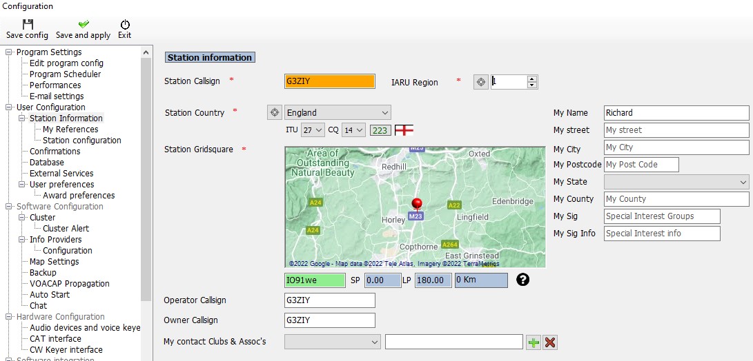

Hi Terry, thanks for replying. I think I'm all set up correctly. A screenshot is attached.
I noticed this when operating FT8 on 5357 with an audio offset of 600Hz, which is a carrier of 5357.6 with something like 50Hz of sideband, well inside the 5354-5358 allocation.

Problem is that when on USB Log4OM does not realise that your only using 600hz audio offset it just receives the frequency from WSJT which as you say is 5357.6 which is above the "Highest USB frequency 5355" if you look at the RSGB bandplan.g3ziy wrote: 31 Jan 2022, 10:14 Hi Terry, thanks for replying. I think I'm all set up correctly. A screenshot is attached.
You can modify the bandplan_DXCC223.xml and make it a user bandplan by changing the top frequency which at the moment is set to the RSGB parameters as below.
<BandPlanRange>
<Band>60m</Band>
<Start>5354</Start>
<End>5357.001</End>
<EmissionType>PHONE</EmissionType>
</BandPlanRange>
Or operate 600hz lower and use the admiral WSJT split (Fake it) system to stay in band
