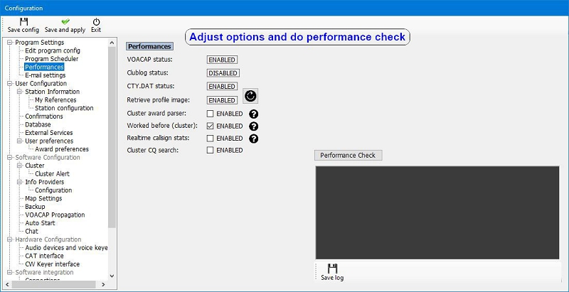

Images below show some locations you can tweak / adjust and check performance to see if any given item are causing the 'drag'.
I have a very old (2007) Dell D830 laptop that I've simply labeled: "Old & Slow". I have to throttle a number of items else the processor on the Dell D830 runs it little legs off and just slows things down.
I even tailor the ve7cc-1 cluster I use for spots that work best for me. I'm 99% CW so don't want to see FTxx spots or RBN spots (save for special times/events). That helps funnel the flow from the cluster(s) as well.

Try also
Settings/Program configuration/Program Settings/performances and un-check any of the 4 choices that you dont require
Try also Settings/Program configuration/Voacap and disable it if you dont use the propogation facility
