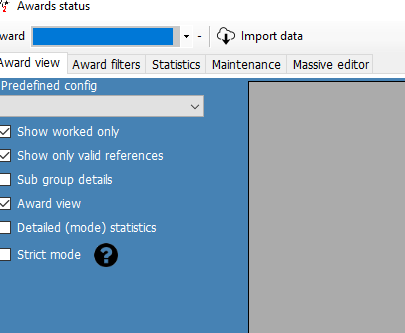

All,
I installed the latest version on my new pc and I copied the user directory to my new pc.
All is working except the Award Status.
I cannot select any award, see picture. There is even not a list from awards in the pull down menu.
What did I do wrong ?

Re: New PC - Award Problem
Have you tried updating the awards from the settings/update resources/Log4OM awards menu?
Then restart Log4OM
Post by ON7CL »
Yes, I did that but no go.
Post by ON7CL »
I did a clean install now all working.
