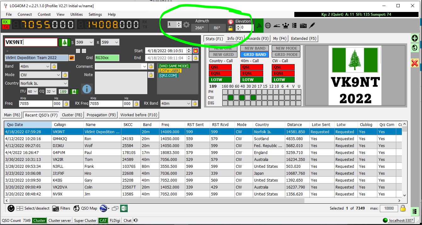

I'd like to be able to send a control message via the control port to trigger Log4OM to send the azimuth to PSTRotator.
I have an external utility that controls my antennas and when the hex beam is selected I'd like to have the antenna automatically rotate to the azimuth in Log4OM.
I can watch for the call sign change and then send the command.

Doesn't it already work that way with PSTRotator - it does for me.
When I put the callsign into the window and let Log4OM get the details filled in, I simply look at the Azimuth window (to the right of the frequency readouts) and press either the short path or long path heading and the command is sent to PSTRotator.
If I have misunderstood your question I apologize, but it's a feature I use every contact on 40m thru 6m.

Yes...I can click on the azimuth in Log4OM...but I'd like to be able to be able to automatically point my beam when the beam is in use.
My antenna controller program knows which antenna is in use and could send a move command to Log4OM to send the azimuth over. What my program does not know is the azimuth so that's why using Log4OM's existing capability to do this would be better.
