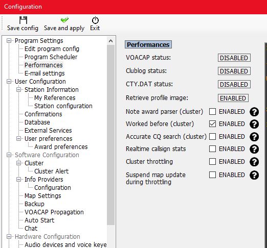

You and/or your friend can enable/disable various elements that can assist, but all depends upon an OM's personal usage preferences. Here are some screen clips of how I currently have my installation set. I'll make many changes for testing and also when events such as the weekly CWTs are running as there can be a lot of cluster traffic during those events.
Once you make such changes I suggest that restarting Log4OM for them to lock into place as well.
Turning VOACAP on/off is under Configuration/VOACAP Propagation
