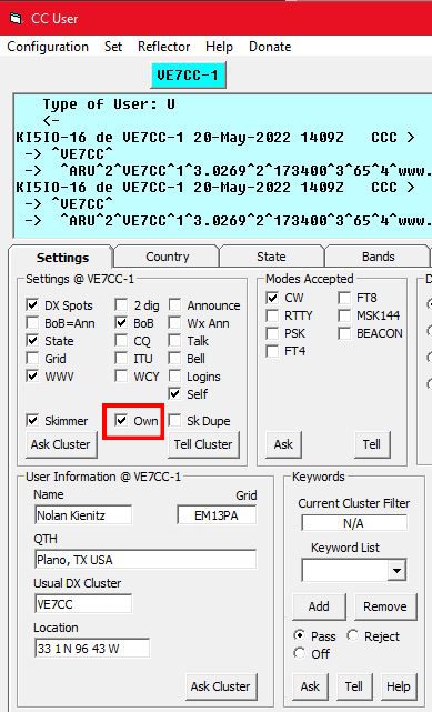

As for ve7cc-1 and other clusters that are feeds from ve7cc also have a tic box in the CC User / Settings panel called "own" that allows spots of your own callsign.

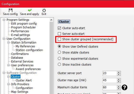

Also I also tend to NOT run the clusters in a 'grouped' option as I've found that my own spots will seldom ever filter through Log4OM's filtering system when that is checked.
But it does make sense to use that option when running a number of clusters else you will get duplicates of duplicates of spots otherwise.

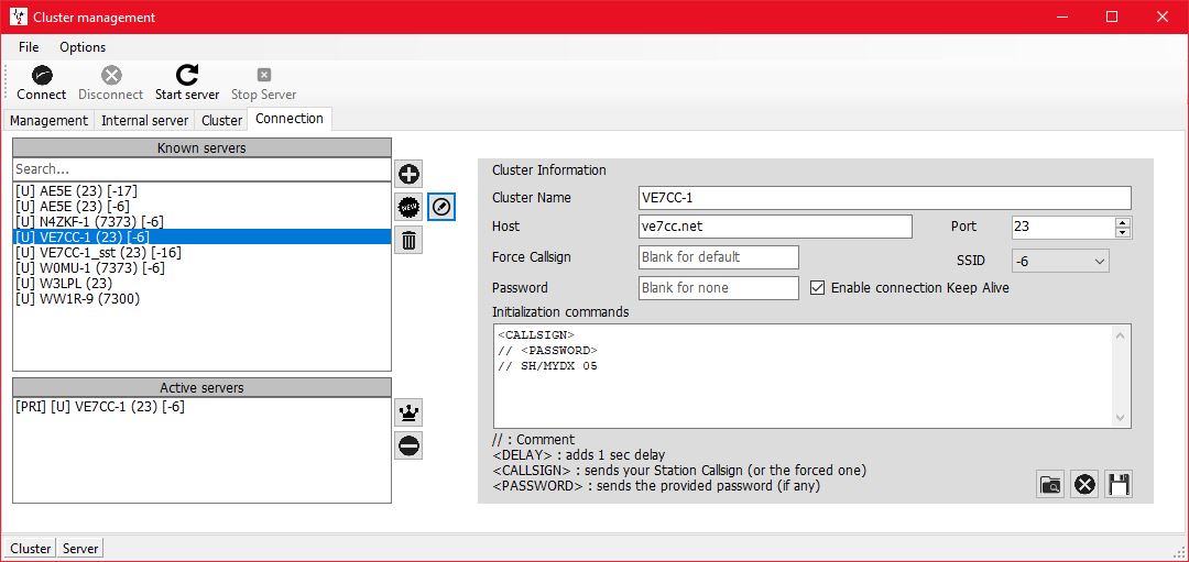

As for login to the clusters you have chosen ... that is dependent upon how you have set up the chosen clusters in the Telnet Cluster Management area.
Default programming is to send your callsign as that is (usually) the defacto login parameter used by clusters. Some have passwords as well, but most do not.
Couple screen clips below.
