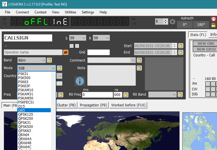

For some reason I can no longer log QSO's made using Q65 after the last update? I also cannot edit a QSO to change the mode to Q65 because Q65 is not in the mode drop down list, am I missing something?

Again last update tells us nothing, exactly what version are you using - Help/About
Q65 is deffinately included see below
Have you perhaps removed it in Program configuration/User preferences list?
Did you try Settings/update resources/modes?

Thanks Terry, after I did the update->Resources->modes I see Q65 in the mode list! I am running 2.17.0.0

I am seeing this same problem again but this time the update->Resources->modes does not seem to fix it? 73s de Tim (N0TB)
Re: Q65 Not in mode list?
Tim,
You can edit the modelist.csv file and add it yourself.
Go to: Settings / Resource Editor and then select the modelist.csv file from the left panel. Edit as you see fit. When saved it will add _user to the filename so it will not be over-written with updates of Log4OM V2.
