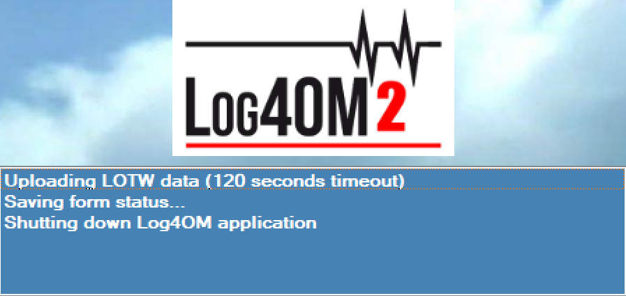

My LOG4OM program (version 2.23.0.0) seems to hang when I want to close it.
For minutes it keeps showing this:
What could be the reason for this behaviour?
It worked before, but after I filled in LOTW details it gave this.

Hi y'all,
Earlier this was not the case, but now, when I close WSJT-X first and LOG4OM after that, it closes down normally.
