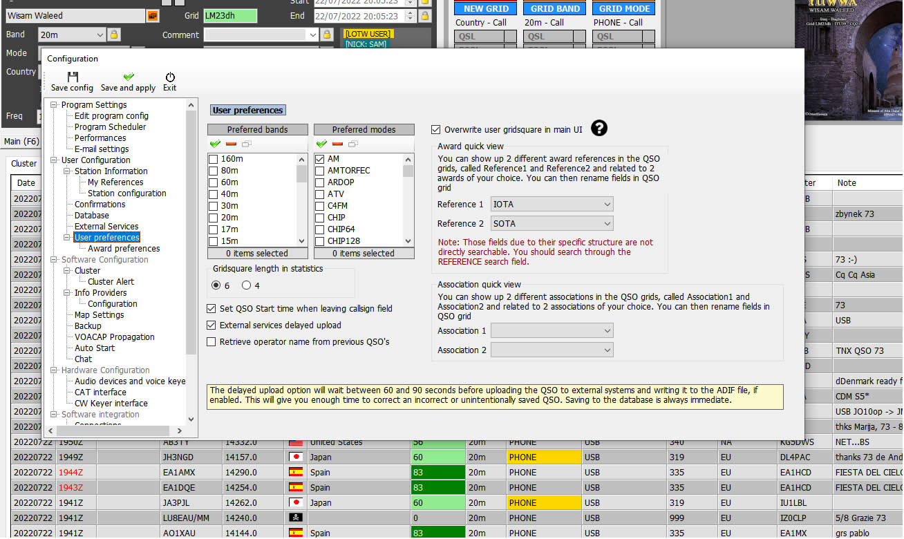

Since the last update I have noticed that setting the QSO start time when leaving callsign field is no longer working despite me having the "Set QSO start time when leaving callsign field" option checked in the user preferences, I'm having to manually set the start time, is this a known bug?

I'm using version 2.23.0.0, it's a strange because it was working fine then just stopped working.

Have you re checked the setting in the program config is checked still?

Yes the check box is checked.
