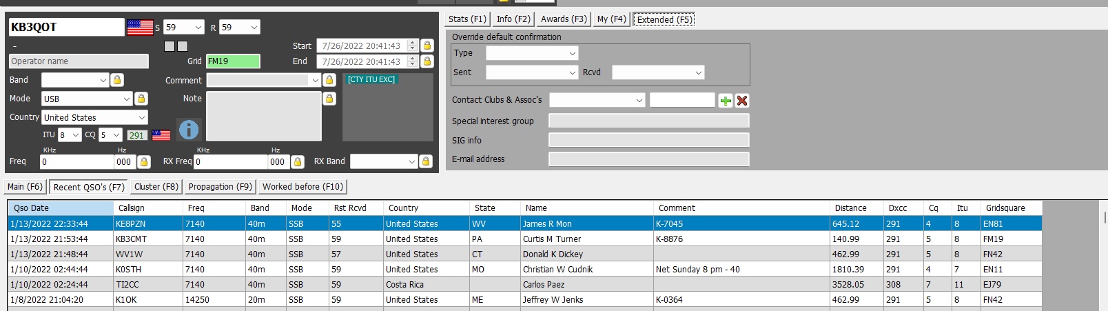

I've migrated my LOG4OM from my previous computer to a new one. I brought over the SQL file and imported the adi file. Everything seems to be fine on the new one, except the QRZ lookup isn't loading when I enter a QSO. I don't see the person's name, nor any specifics about them. I checked that I entered the proper key, which I did with the same parameters. I still get QSO info from QRZ on the old one, though not the new one. Please see screenshot.

Does not seem that you have a QRZ account when I look up KA3GOT its call sign not found, you must have a QRZ paid for XML account or a Free HamQTH account for this to work.
Did you follow the instructions about Info Providers on pages 189 and 190 of our user guide?
