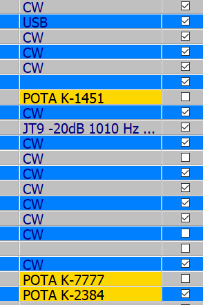

Previously, whenever a POTA station was noted in a cluster spot's comment field, it would be highlighted in yellow (to my eyes) ? Similar to the band and emission type in the attached screen grab. Today it seems that POTA does not get highlighted. As far as I know, I did not change anything. This happened once before, but the yellow highlight returned after a day or two. I DO have "POTA" in the "active" Awards list for cluster and UI Identification.

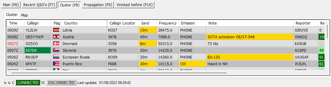

Screenshot 2022-08-01 103123.png (32.45 KiB) Viewed 1292 times

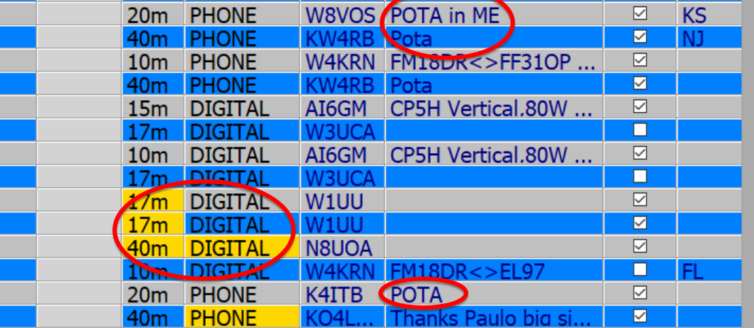

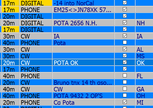

but... interesting that right after I re-enabled and saved cluster award parsing, I saw the note field highlighted in yellow. Then, subsequent spots with POTA in that column are not highlighted ( even though not worked before). Parsing is still enabled.
Andy K3UK
Re: Colors for award interest in cluster ?
Its expecting a proper POTA reference to trigger the alert like LA-2041
POTA or I am in a park wont hack it

Yes. Takes my brain a bit longer than yours Terry. I was just thinking the same thing when I saw some later spots with the POTA reference highlighted as one would expect.
Andy K3UK
And what is frustrating (to me anyway) is that those of us on the receiving end are relying on whomever is posting the spot to properly enumerate the POTA location in the Notes field.
Does not happen that much from what I've seen.
