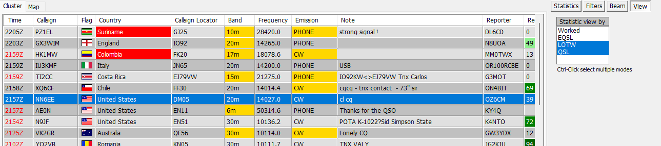

At the moment, if a country is not worked I have it highlighted RED. If it is worked but not yet confirmed (LOTW) I still want it highlighted in some fashion as my initial contact may choose not to confirm so I want to keep working that country until a confirmation is made. The logic of how to do this is escaping me.
Suggestions appreciated.

Ray,
As you know I've answered via e-mail. The options are already in Log4OM V2 and done via selecting modes in View / Statistics View. Terry - G4POP provided me with the image below.
