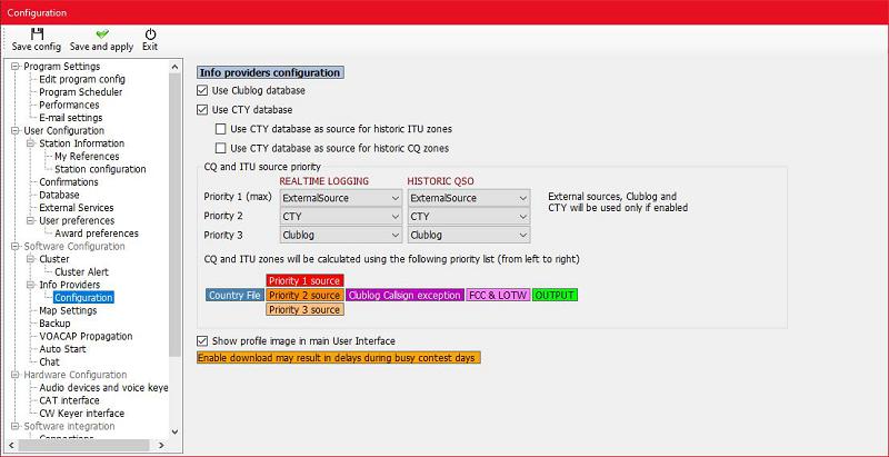

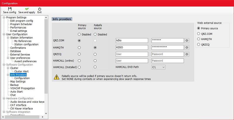

Jeff,
Disabling the QRZ.COM Info Provider will not have the globe bring up qrz.com for data lookups. Thus it may gray out indicating it is not active.
If you have NO Info Provider enabled Log4OM will review your log as WB4 data and will also scan the Country and Clublog data files.
FWIW - I've included screen clips of my current Info Provider configuration.

Thanks for the screen shots! I rearranged the order of my priorities to match yours. (I had mine set the way the came from the author of this software) It does not change anything... I still get the delay up to 3 minutes in some instances! If I uncheck the "Show profile image in main user interface" then we are working as normal... but no image. My issue has to do with the image for some reason! What puzzles me as is to why and why all of a sudden. I have never had any issues with this!
Again, QRZCQ does not present this issue, but they do not have a abundance of user that have the images available on their accounts. I also have registered with HamQTH and it works great via my browser. When I set it up as my failsafe source when I test it I get an error! I have double checked the account name and password multiple times. Not sure what the issue there is.
