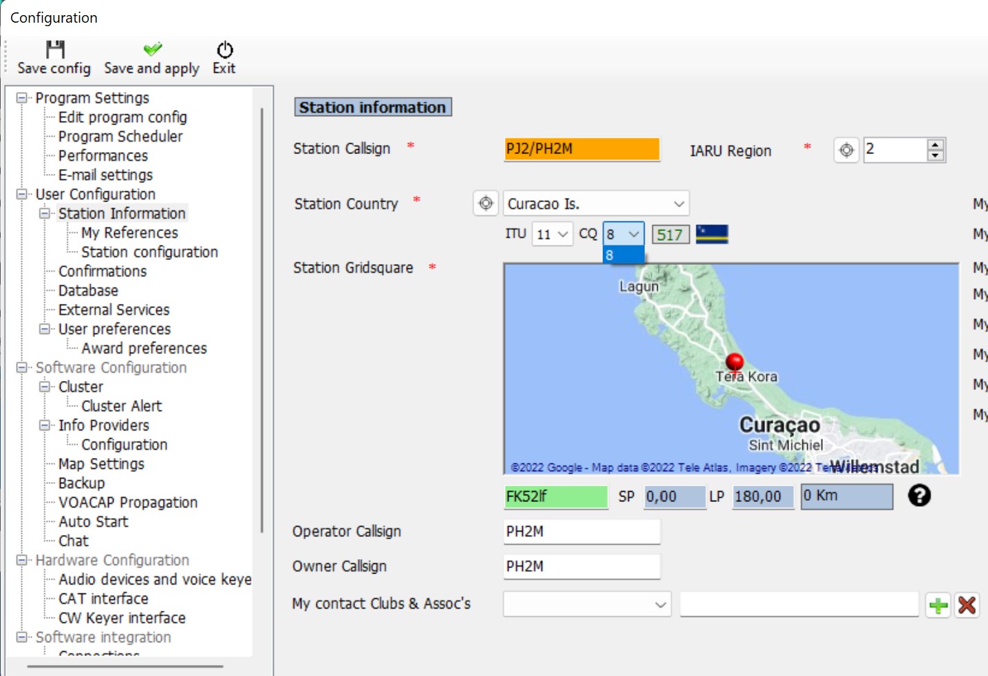

Hello all, started my holiday style DX-pedition to the island of Curaçao yesterday evening found uploading to LoTW not working with a location error, all selections are correct for TQSL but found MYCQ in Log4OMv2 set as CQ Zone 8 instead of CQ Zone 9, I seem to be unable to change this to CQ Zone 9 :oops:
If I check e.g. logging PJ2T it shows ITU 11 + CQ 9....
Please help,
Best 73 from the sunny island of Curaçao: Frank PJ2/PH2M - FK52lf
Log4OMv2 PJ2-PH2M settings.jpg (187.89 KiB) Viewed 627 times

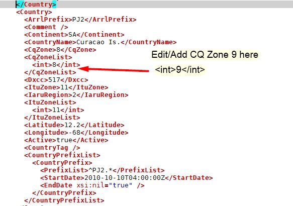

Go to: Help / Open config folder
Search for and open file called: country.xml
Search for: Curacao Is. or 517 (the DXCC ID)
In the CQ Zone List add: <int>9</int>
Save the file. Close and restart Log4OM V2 and you should now be able to find the CQ Zone 9 for your configuration settings.
