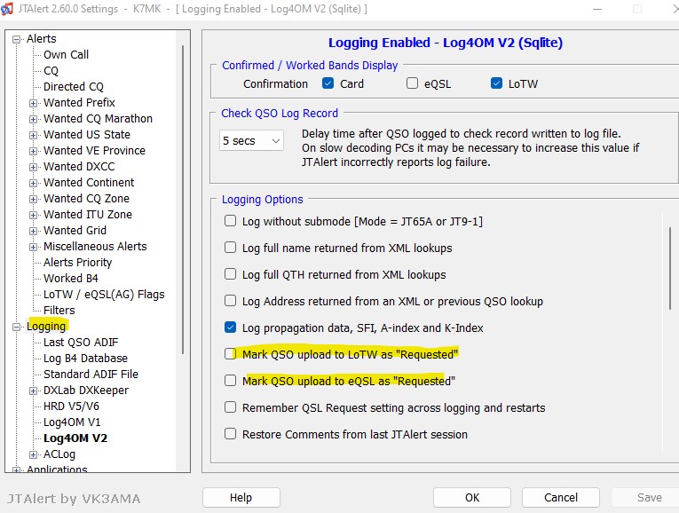

Since this thread just helped me, thought I would add a screen shot of what needs to be unchecked in JTALERT. I was having the same issue with normal Log4OM logging would have "NO" for sent/receive defaults (preferred), but the QSO's coming in from JTALERT were set to "Requested" for sent/received. Thanks for sending me over to the JTALERT settings as I was (rightly) struggling to find the setting in log4om (after RTM and watching the requisite 3 YouTube videos) for inbound QSO defaults (exists in JTALERT not Log4OM).
Anyhow, thanks! Jim/K7MK
