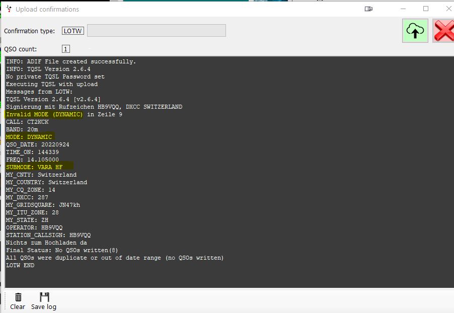

I just started to experiment with VarAC on HF and had my first QSO with CT2KCK. The contact was logged like this
Mode: VARA HF
When trying to upload to LoTW I got this

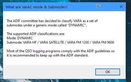

According to the ADIF rules Mode:Dynamic and Submode: VARA HF is a valid entry
I know this is not directly to an issue with Log4OM but rather with LoTW. Uploading the same QSO to qrz.com and HRDLolg, Eqsl etc. works fine. Need to dig into LoTW....

Seems like the valid ADIF mode is still not accepted by LoTW....
https://lotw.arrl.org/lotw-help/frequen ... ons/#modes

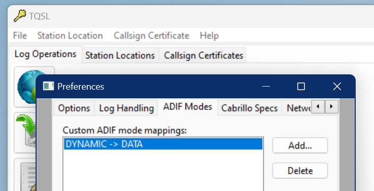

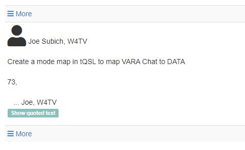

Re: VarAC Mode LoTW issue
This has been discussed on the LOTW reflector and Joe Subich - w4tv offered a suggestion.
HB9BRJ
Posts: 174
Joined: 23 Nov 2014, 10:46
Location: Schaffhausen
Post by HB9BRJ »
Thanks Nolan for the workaround.
I was able to upload my VarAC QSOs.
73, Markus HB9BRJ
