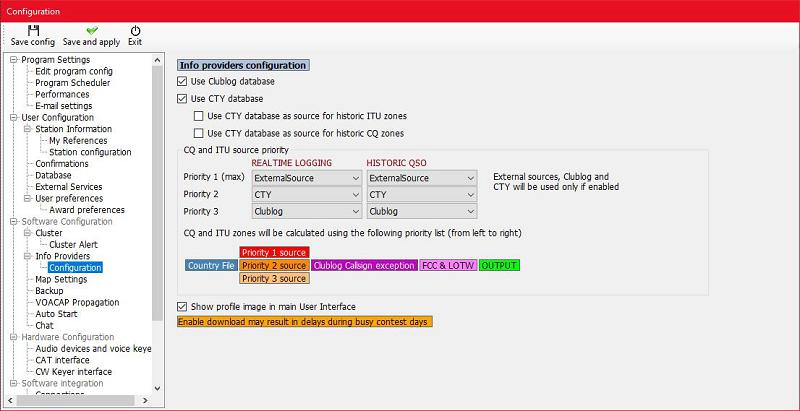

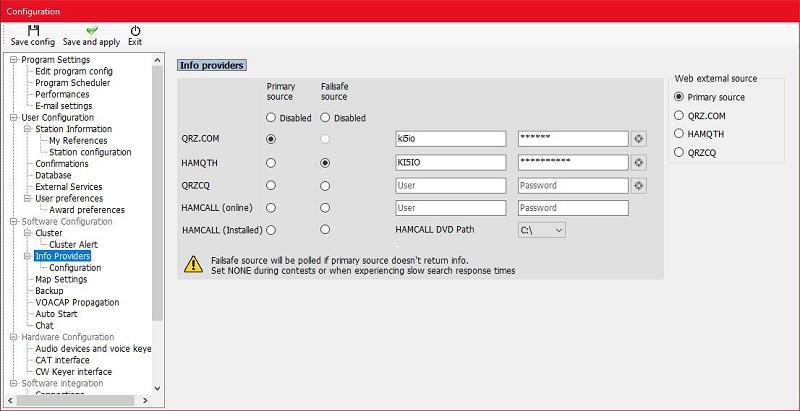

What is your current setup for "Info Providers" and "Configuration"?
Are you using QRZ.com and/or HamQTH as part of your callsign lookup?
There have been many posts about Gitmo Bay calls and usually the issues ends up being how the OM set up the two items I asked about above.
If you would pls provide screen clips of what you have set up for those two elements that will be helpful.

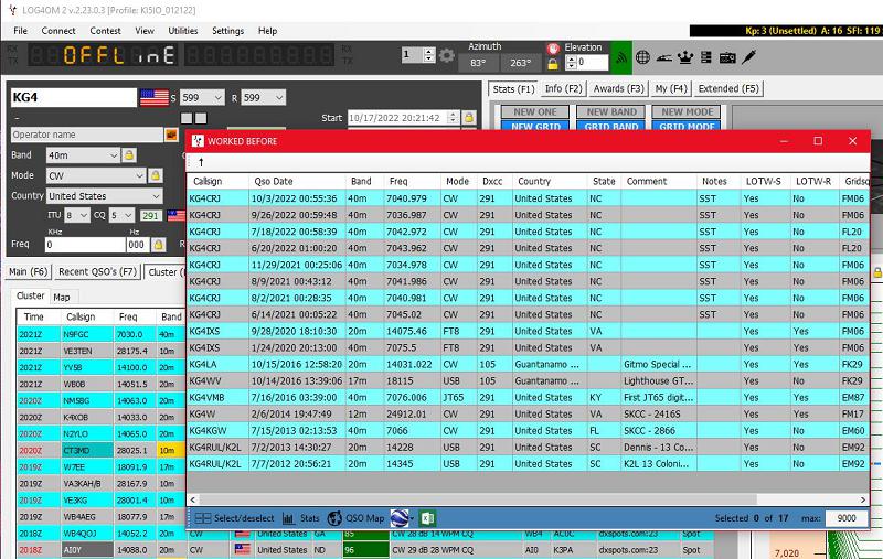

I asked for you to provide screen clips of your Info Provider and Configuration setup, but I've not seen them. That being the case I've attached screen clips of my current settings for that.
I've also include a screen clip showing my 'Worked Before' list that appears when I simply enter KG4 in the Main UI.
As I noted in a post above issues with the Gitmo Bay sites showing up are usually always due to an OMs settings in their Log4OM V2 configuration.

Tnx Nolan for your suggestions, I don't have a paid subscription to qrz.com but a free profile, the LOG4OM version is the latest ie 2.23.0.0, so I applied the changes in the realtime logging and istoric qso boxes. I hope that now I get correct news. I will keep you informed thanks 73

Suggest that you register and use HamQTH instead of the QRZ lookup you will get almost as much data as a paid QRZ subscriber
