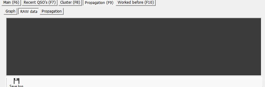

Guys I am running v2.23.0.0 and have been successfully running LOG4OM for some time. Recently however, I have lost the solar data in the propogation tab and the panel that indicates KP: A: and SFI is not updating. See attachments.
Must be something simple but I cant crack it!
Your help appreciated.
Regards
Graeme ZL3GK
raw data.JPG (23.74 KiB) Viewed 946 times
Solar information.JPG (11.27 KiB) Viewed 946 times

Update to the most current version of Log4OM. This has been corrected. The failure was due to programming changes at the source of the data. Lele made changes in Log4OM to accommodate the providers changes.

Thanks Nolan, but still no change. I have updated to v2.24.0.0 but still no updates.

There must be something wrong in your Firewall/Antivirus. Since we have implemented solar data from NOAA
it has been worked very well. Except a little problem with a change at NOAA site but this was fixed in the last
BETA 2.24.0.5.

Tnaks Jeurgen, I have disabled my firewalls and antivirus and still no change. I might try and restore a previous version but I doubt this is the issue.

Please update to BETA 2.24.0.5.

I can confirm that the new 2.24.0.5 Beta fixes this problem.

NOAA changed the file format :-(
