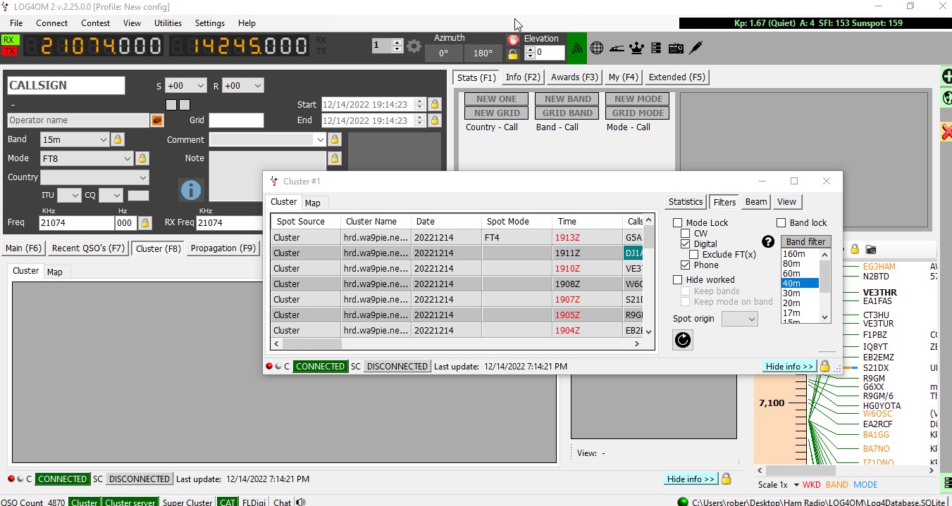

When I opened LOG4 yesterday the Cluster tab was blank. The Map tab still works. The cluster comes up from View/Cluster View from the top menu bar, see attached screen shot. I loaded a newer version, 2.25.0.0 and still have the same problem.

Check your Filters tab under the cluster screen and see if you have something checked like Hide Worked or other options.

Thanks, It was the Spot Origin. It had been changed from blank, for any, to AF by accident. The View Cluster windows from the top menu bar opens up windows with the default Blank setting.

The idea is that you can have different filters set in multiple cluster windows
