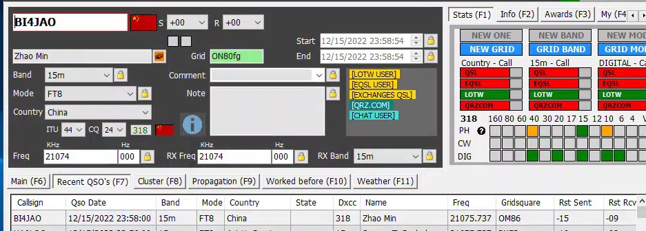

I was able to catch an example of the issue. No grid was entered in WSJT-X/JTAlert. The lookup was correct, but not used in logging the contact.
Grid Issue.jpg (116.15 KiB) Viewed 627 times

Re: Wrong Grid Square Logged
Because we dont update incoming qso's from JT programs, what is saved is what is received, not what we find on lookup.
Suggest you set your JT software to do the lookup while data is saved in JT program
