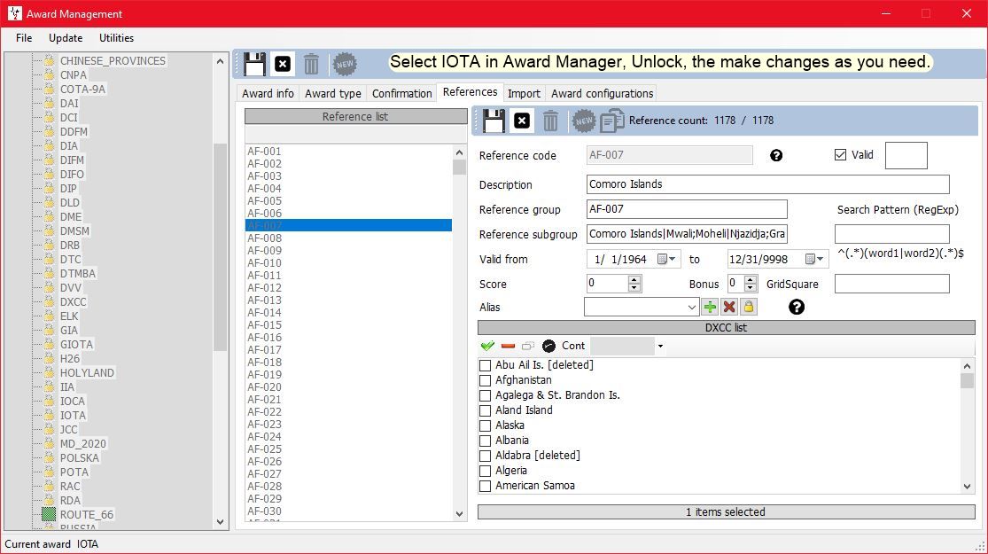

You can go to Award Manager, select IOTA, unlock the file and go to the References tab and locate the Island ID and make your changes. And/or you can add a new Reference in the same area. Just make sure you then save your changes.

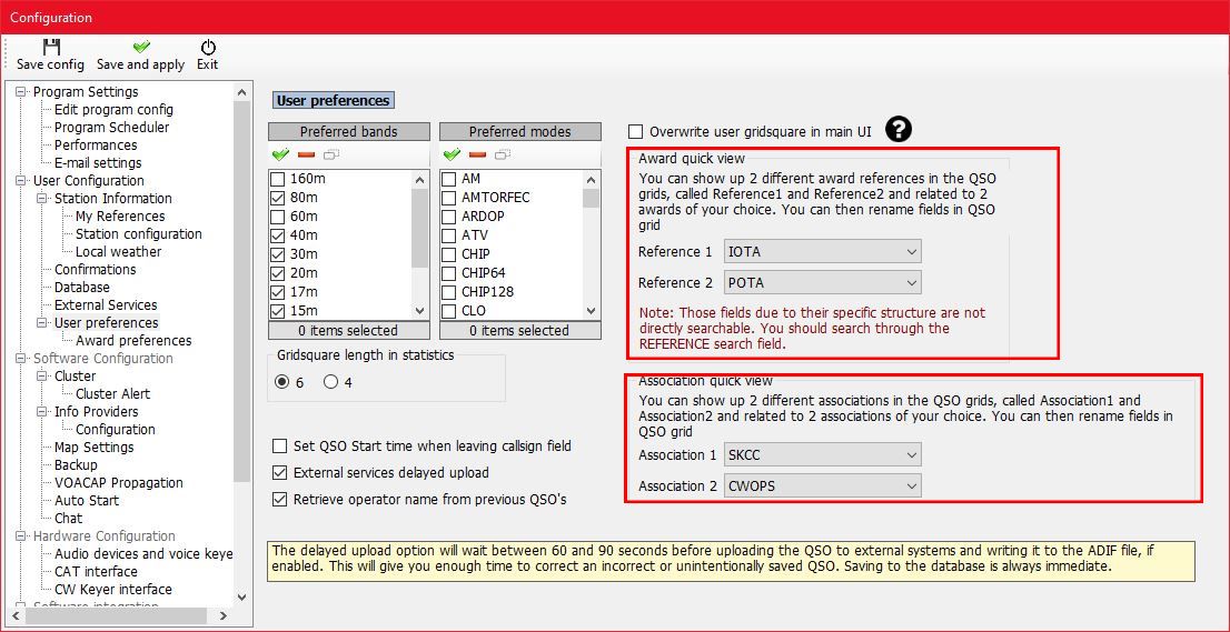

As for having an IOTA column in any given grid you can assign IOTA to several 'free form' columns that are available. You can then be sure to select that column to show up in the repective grid ... IE: Recent QSO's (F7) for example.
You can adjust "each" grid to show or not show that column.

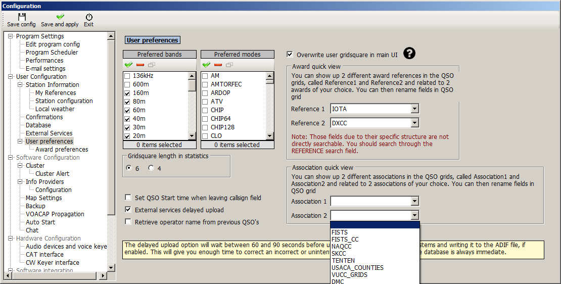

Images below may help out a tad.
- Config-UserPrefs-1.JPG (129.78 KiB) Viewed 1374 times
- AwardIOTAMngt.JPG (113.5 KiB) Viewed 1381 times

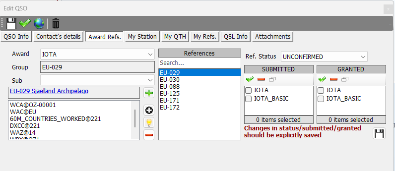

Re: IOTA, was Missing LoTW download
Hi Nolan and Terry,
thanks for your time and detailed explanations.

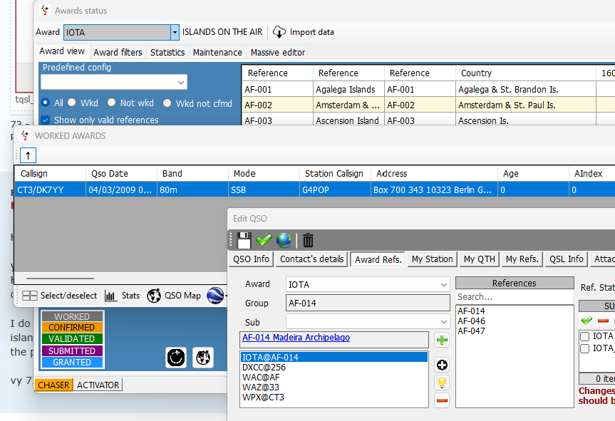

I unlocked IOTA in the Award Manager although I am not looking for any award, I take IOTA numbers and island names solely as geographical information.

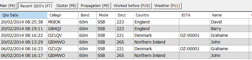

I could enter IOTA in the column "Reference1". Now the IOTA number is shown in the Recent QSO's list, but still labelled as Reference1. No island names are shown; this information is important, as sometimes several islands share the same IOTA number.
I found no way to enter IOTA related information in the Association field: IOTA is not shown in the list of selectable items.
I found Log4OM v1 much easier to configure, it did offer according columns right from the start, in the recent QSO's list as well as in the Update QSO window.
I wished this information was accessible easily in v2 too, without this workarounds with references and associations. Maybe the procedure is comprehensible for award hunters...

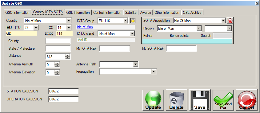

Please see images below.
73 de Willi, DJ6JZ
