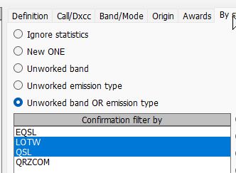

I create an alert for FT8WW (Crozet) and I do the following manipulations
1) I name my alert FT8WW Stats
2) In the Call/Dxcc tab I confirm well FT8WW
3) In the Band/Mode tab I select all the bands as well as the different types of emission
4) in the "Origin" tab I do not select anything
5) in the "Awards" tab I do not select anything
6) in the By stats tab I select "Unworked band OR emission type and I select "Confirmation filter by" LOTW +QSL
I therefore expect to have an alert on each spot on FT8WW but I have no alert that is triggered
Thanks for your help
2023-01-06 16_49_36-Alert management.jpg (16.46 KiB) Viewed 311 times
2023-01-06 16_49_17-Alert management.jpg (29.19 KiB) Viewed 311 times

as nobody answers,
I made several tests
and obviously the alert system according to the statistics does not work
finally it is what I can conclude from it here...
