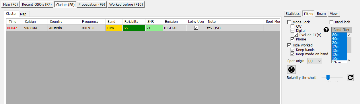

Am I missing something? FT(x) Spots still coming through, see screenshot.

HB9VQQ wrote: 22 May 2022, 12:02 Am I missing something? FT(x) Spots still coming through, see screenshot.
I cant see the frequency because the screen shot is to small but I am willing to bet its outside the special FT8 frequencies below

It is 28076 well within the 2kHz of the FT8 segment. I see you are not looking at a range, only at a single fixed frequency. If the reported Spot is not exactly on that frequency, but still within the FT8(x) segment it's a miss.
