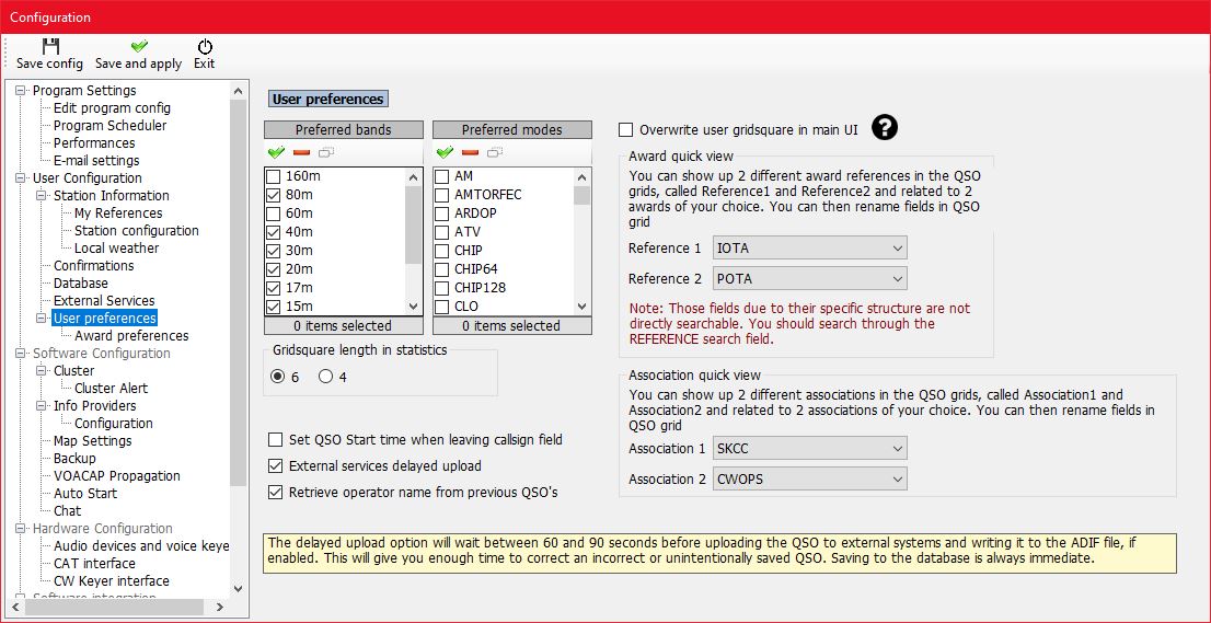

As a newbie, I think I must have done something stupid and deleted something accidently ...
After adding a radio and then an antenna, I can only add one band (20m) under the antenna. The green box that pops up on the right when you click the band icon only shows the one band (20m). How do I get the other band options back?
Thanks!

Dan,
Go to: Settings / Program Configuration / User Preferences
Once there you can adjust your preferred bands in the left column/table. Once you make your adjustments, be sure to tap 'Save and apply' to put into effect.

Thank you!!!
