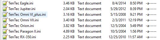

If you use Omnirig there is an ini file for the Tentec Orion ... Image below shows all the available TenTec ini files in the current ini zip file.
That should work for the Orion 1
Be sure you are using Omnirig V1.2 from Alex - VE3NEA. Do NOT download and use the version from the Suisse developer as it will not work with Log4OM V2.
