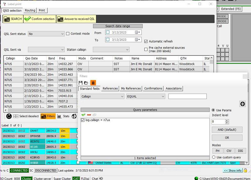

Re: Print label for more than one QSO to a ham
Hi Nolan,
I used the filter as you see on my attachment.
How do I go on after I have choosen both QSO:s in this case?
Hi again Nolan,
I quit the filter and got the two QSO:s.
Tnx!
Tnx!
